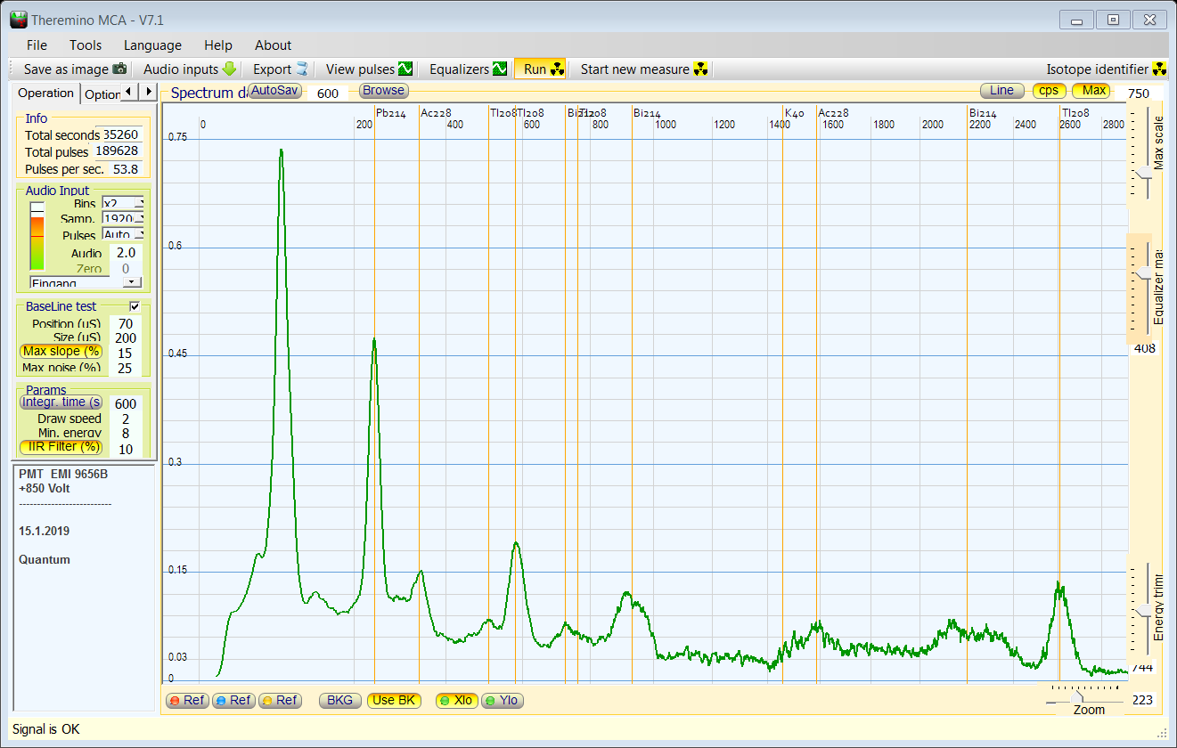

with 1 gram you must see the lines. Here from my system.
Lu Ka is near 53-54 keV

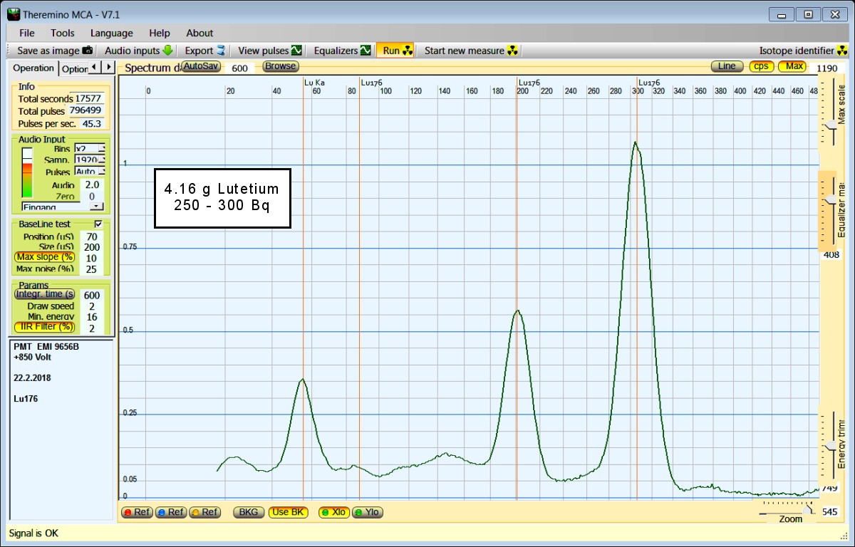

Yes sure, here is a previous Lu spectrum obtained with my 1cm³ CsI detector :
What is your Lu Ka line ?

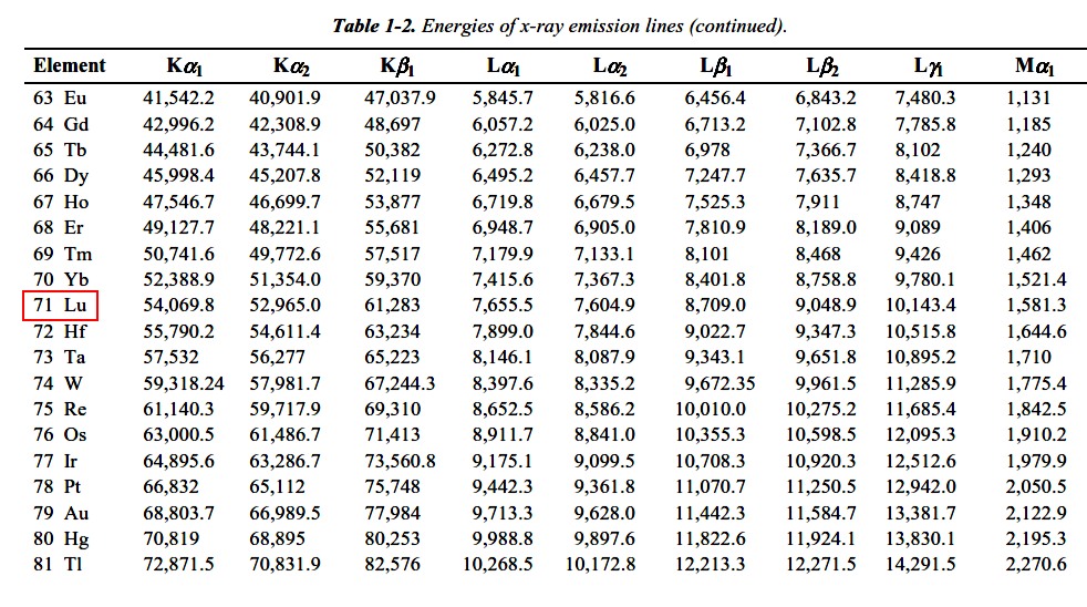

Hello,
here a small chart for the x-ray lines.
