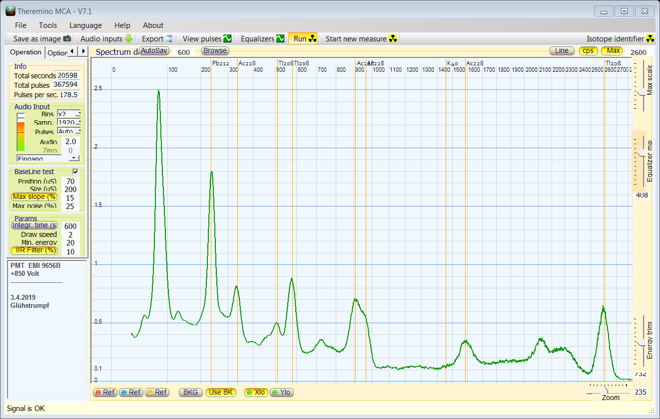

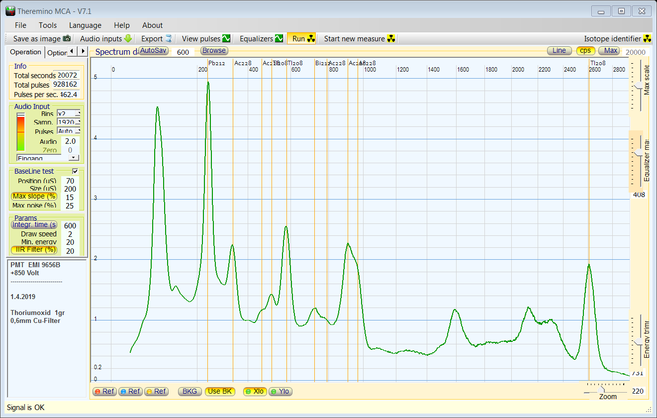

Hello Steven,
i have a problem with your thorium spec. What are the last 3 peaks?
Here my spec from thoriumoxid.
Steven Sesselmann
Posts: 611
Location: Sydney
Re: Energy per Bin (Channel)
Post by Steven Sesselmann » 02 Apr 2019, 20:17
Peter,
If I am not mistaken, the last peak is Ti208 at 2614 keV, the second last peak is the Compton edge and the third last peak is the pair production escape peak (2614 - 511 = 2103 keV)
These are also visible in your spectrum, but not so obvious.
You have an extra peak at 1600 keV in your spectrum, which I think may be K40.
Be careful with Theremino because the rubbery calibration system can move peaks to wherever you want them.

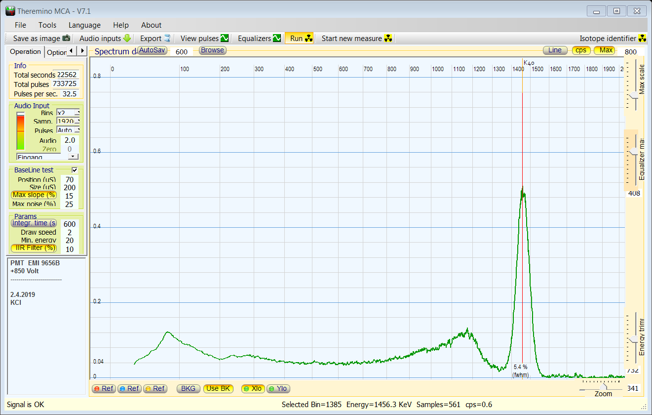

Hello Steven,
I think my calibration is ok. I tested with Am241 Cs137 K40 Lu176 Ra226 Kr85 and Th
Here my last test with KCl -> K40

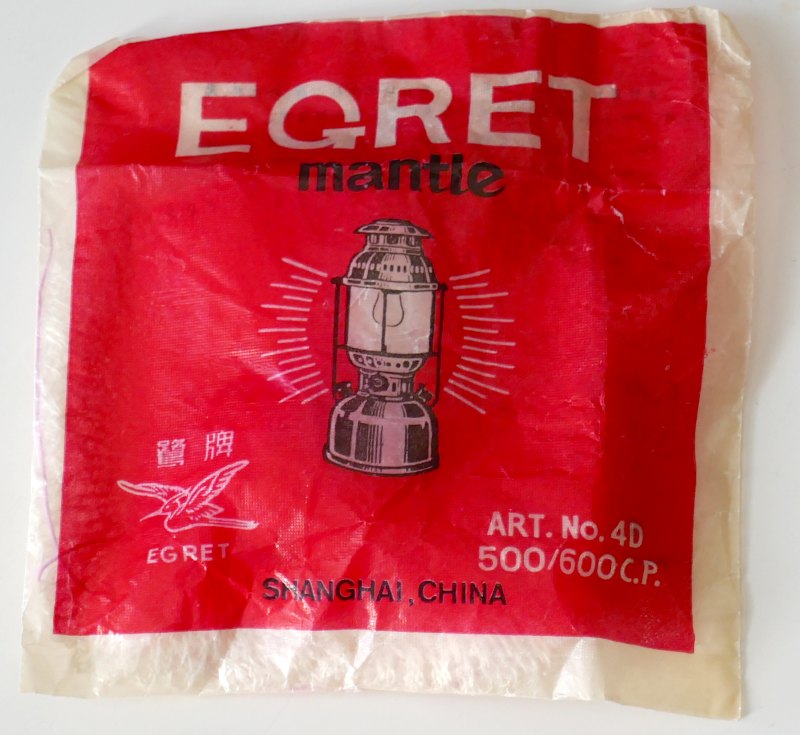

Hello Steven,
I have a mantle like this here.
and as you can see, its the same spec with a peak at ~1600 keV. Ac228 ???
