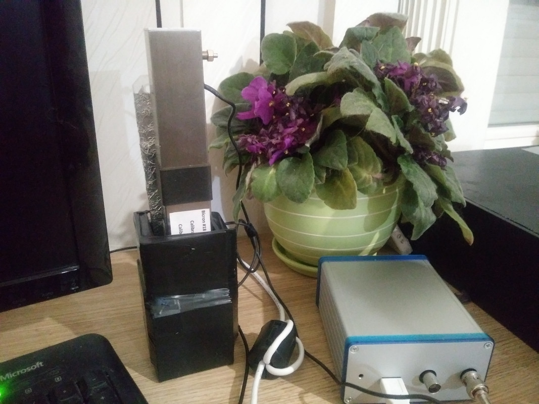

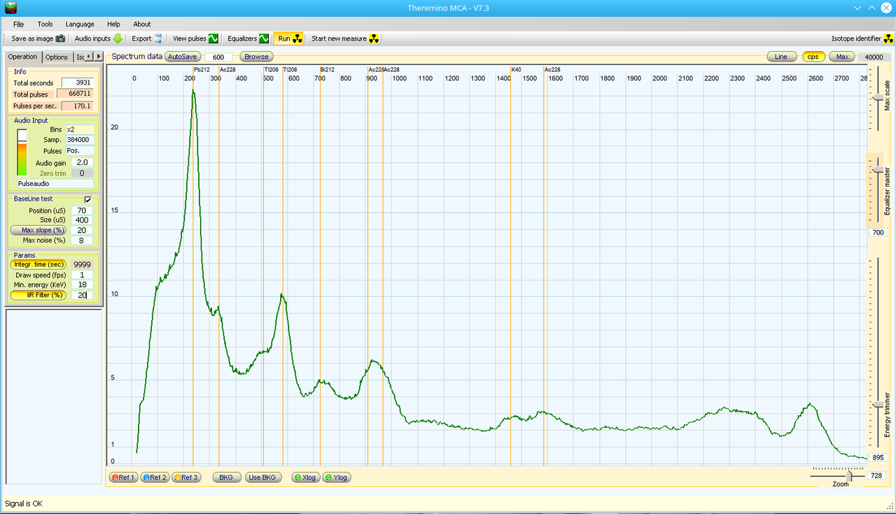

That said, natural background is pretty boring at home (even radon daughters barely visible on the spectrum). Right now, the "hottest" thing I've tested (and it makes a good poor man's calibration source) are those thoriated tungsten welding rods - I have five of them, 17.5cm, 1.6mm diameter. I measured them (sloppily) for about an hour or more in my poor "steel castle" which was made by steel Г-profiles about 1.5cm thick (and give about 2.1x overall reduction in CPS):
The thorium series products are quite noticeable. Hopefully I will soon build a real lead castle and go find some interesting rocks to test. We have a granite mountain nearby which is a popular tourist destination, so even without lurking around the former uranium mines, there are still probably some nice rock samples to test...
