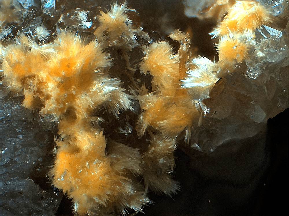

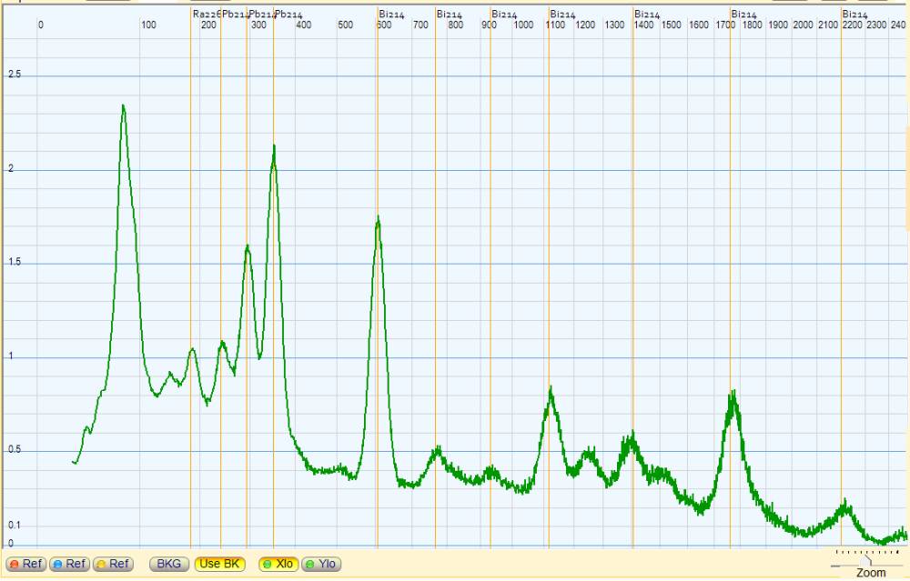

I also found a radioactive rock, which contains uranium, the following spectra shows this fact:
I also attached some pictures of the collected mineral. Sadly i don't know anything about minerals or rocks, but maybe someone here in this forum know about them and might could tell me what the found mineral could be?

Post by Svilen » 15 Sep 2019, 06:09
This was definitely a nice trip and mineral hunt you had there. I also don't know much about minerals, but maybe the black spots are small amounts of Uraninite in whatever rock matrix. You may also illuminate it with UV light to see if the yellowish substance is fluorescent, could be traces of Autunite for example.

Post by Go-Figure » 15 Sep 2019, 23:59
Interesting,
I can't help you with the mineral identification. I have a book about radioactive minerals but I am not an expert, so I could say something very very wrong.
Yes, the spectrum is definitely U238-Ra226. In my experience it's unusual having peaks from Th234 and no X-rays from Pb214 when testing this kind of samples, so that's interesting!

Post by gwgw » 16 Sep 2019, 08:08
I also have that peak around 90-95kev (might be offset due to poor calibration at lower energies). And I have it every time I measure something of minor activity, but it's much better pronounced when I measure higher activity samples. I don't think it's from Thorium, more like XRF of some kind, probably from my shielding. I was even considering posting a question about that.

Post by Go-Figure » 16 Sep 2019, 08:34
gwgw wrote:
16 Sep 2019, 08:08
Fluorescence from shielding it's around 80 keV.
Samples with U238 in my experience always have a X-Rays peak from Pb 214 at 74 and 77 keV.
Th234, if visible, should have two peaks at 63 and 93 keV, with similar probability.
I see two peaks quite close to each other here but they are probably a bit too close to each other to be 63 and 93.

Hi guys
Abilene could be correct. The black mineral is possibly uraninite / pitchblende or davidite.
The yellow green flakes could be autunite - which Fluoresces a bright green with SW MW and LW ultraviolet lights. It could also be torbenite - or metatorbenite. This mineral doesn’t fluoresce and is far less radioactive than autunite ( using a Geiger counter)

Post by Peter-1 » 17 Sep 2019, 23:23
Hello,
I have 2 pieces from menzenschwand with very nice needles from Uranophan.
The pulsrate was 240 CPS with background, background only 16 CPS.
