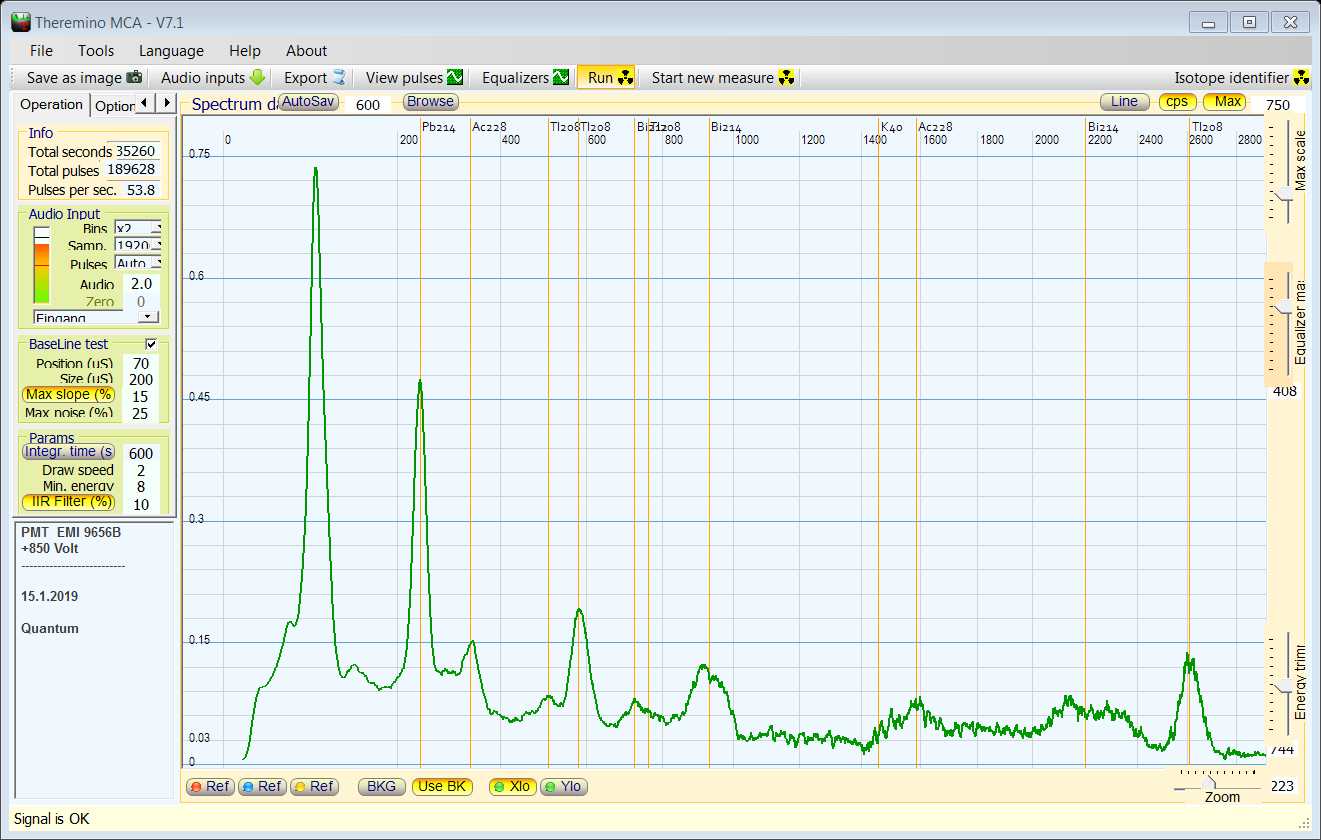

The pendant gives around 1000 CPM with my Geiger counter, almost 20 times my background, but most of it is alphas and betas.
The spectrum reveals there’s Thorium 232 inside and its decay progeny is clearly visible. Gamma activity isn’t that much, just 60 CPS which is less than a quarter of my background, on the other hand the average energy per count is higher than my background therefore in terms of exposure is a little less than 1/3 of my background at 1cm distance (when it's worn it's at contact so it will be a bit more than that). Not really much radioactive, but still no reason to keep it on your skin 24/7 as a radiation protection…
Given the low activity I recorded a 24 hours spectrum with background subtraction. Recording over such a long time (36 hours actually including the 12 hour background) I noticed some small drift in some of the peaks, particularly in the Ac228 peaks at 911 and 964 keV and the K40 peak from the background.
Identification is generally pretty straightforward, with a couple of exceptions:
Around 1100 keV there’s a peak that could be more or less consistent with Bi214 (1120 keV) , but there are no other convincing elements to think there’s Uranium in the object. Around 600 keV the Tl208 peak at 583 keV is clearly there, but no sign of Bi214 at 609 keV, therefore I see no reason to think Bi214 is responsible for the 1100 keV peak, also because it's about 20 keV to weak.
Another peak I cannot identify is the one around 1400 keV. It might be the product of the slight thermal drift of K40 peak happened between the recording of the background spectrum and that of the sample, but the drift appears to me to be too small to justify that.
Could it be K40 in the sample? Maybe, but the peak is a bit too “south” for that explanation to be convincing, it’s centred at 1410 keV, some 35 keV lower than the K40 peak from the background detected while recording this very spectrum.
So I left those two peaks unlabelled.
I also have a peak (better, a Gaussian correlation) at 130 keV, which is consistent with Ac228 peak at 129.06 keV. I know Ac228 is there, so I called it, that’s the first time I identify this peak.
Spectrum is presented in counts per bin and energy per bin and for both there are two views, the only difference is the scale factor in the x-axis, the first gives more details at lower energy, the second includes the Tl208 peak at 2,6 MeV.
Btw the Ac228 peak at 1588 keV is reinforced by the double escape peak.
Also, looking for the 130 keV Ac228 peak in this spectrum I think I might have identified another peak at 130-133 keV which shows up in all my background spectra and it’s probably from Protactinium 234.

Hi Massimo,
that's great fun. I'm feeling much better by laughing. and so you stay young and do not age.
In January, I saw the part and wanted to know how strong it radiates and whether Thorium is clearly visible.
Here is my result. Background 15.7 CPS , with Quantum P. i have 53.8 CPS.
