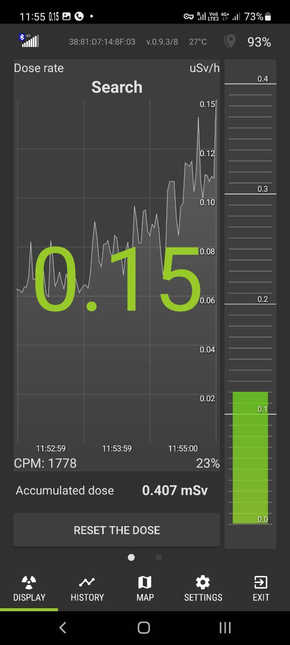

The bluetooth circuit is discoverable by the Atom Radiometer app for iPhone and Android which serves as the user interface.
The detector also provides a single BNC output with a logic pulse  which can be used for data logging.
Screenshot of app interface.
