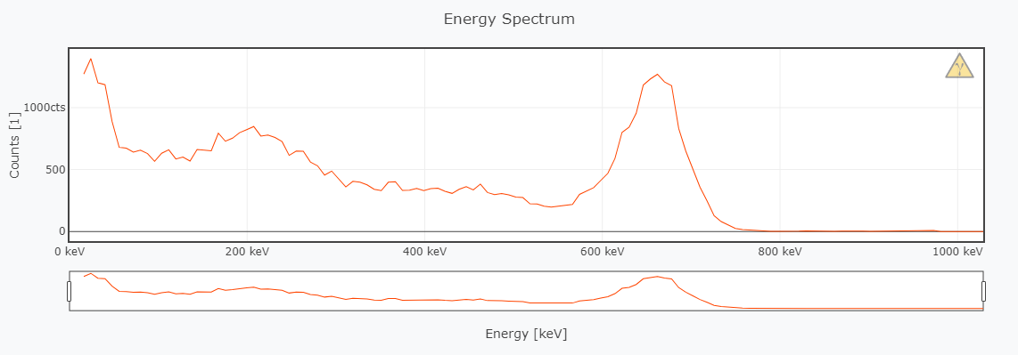

The creator of the BetterGeiger S-1 has released a guide and an Arduino Uno sketch to use his device for basic spectrometry.
https://www.bettergeiger.com/s/Better-G ... de-V10.pdf
With minor changes to his sketch, it can be used directly with NuclearPhoenix' Gamma MCA https://spectrum.nuclearphoenix.xyz/ in serial histogram mode.

RobertD
Posts: 49
Joined: 09 Jan 2023, 22:41
Location: Germany / Bavaria
Re: BetterGeiger S-1 radiation detector
Post by RobertD » 02 Apr 2023, 22:32
Hi Matthias,
What I changed in the sketch:
- comment out all serial print commands except for the actual bin data and the line feed
- insert a separator after each bin value:
Code: Select all
 for (int i = 0; i < 128; i++){Serial.print(spec[i], DEC); Serial.print(";");}
 Serial.println(""); // move to next line
