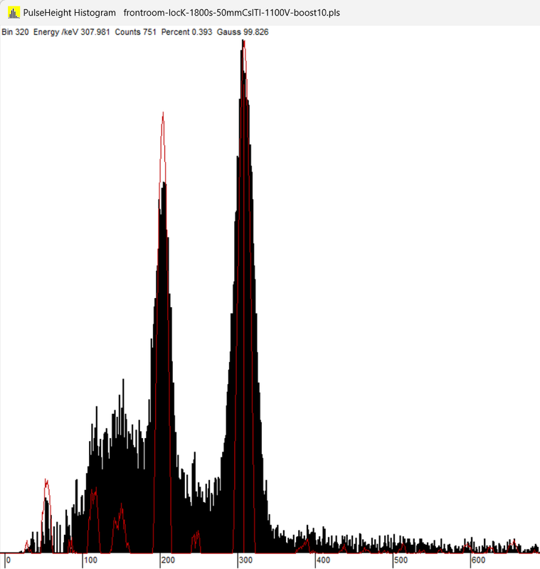

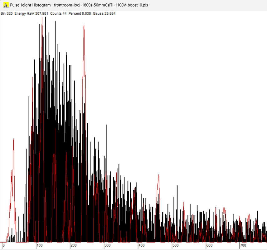

Just this afternoon, something caught my eye on the latest scan - which was different from all the others. Here it is:
can you spot it? This is with background subtracted. In case you missed it, it's the peak at 307keV, which did not appear on any of the other scans. So I knew I was close. I moved the probe about 40cm in the suspected direction, and this is the next scan:
Turns out this last location was within 15cm of the LYSO. I found it behind a couch. No idea how it got there, but now I have it back.
