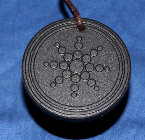

Hello Felix,
Greetings from germany. it's easy to get a source. In the net there is the Quantum pendant. You can get it for 1.- € to 20.- € and it is a good source.
