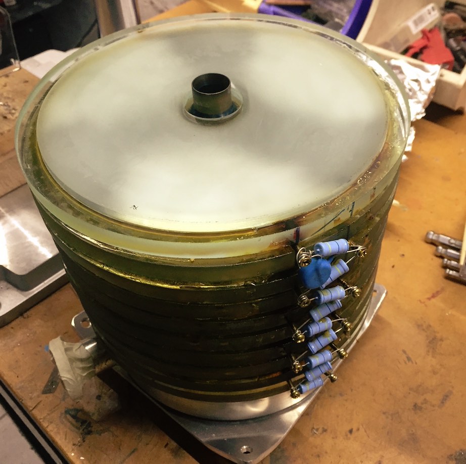

Thanks for your feedback, I happen to be working on a solution very similar to what you have suggested for the flux capacitor. I could use transformer oil, as I have 2 25 ltr. drums on hand, but to make it less messy I have ordered a kg of Sylgard (two part silicone), this is the stuff they use to glue PV cells to glass.

In my FICS reactor the ions created at low potential are confined to the hollow cathode as they don't have the energy to climb out, so in principle at least the pressure (density) of ions should build up inside the cathode.
In reality ions are swapping electrons all the time so neutrals can and will escape.

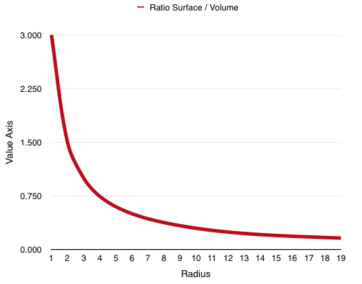

The way I see it, the efficiency of the hollow cathode FICS design should scale favourably with size, because the volume to surface area of the sphere improves with increasing radius, so mu current experiment has a 6" diameter chamber.
Only experiment will show if it works, so now I am just waiting for the silicone to arrive so I can run it and see what else is going to break :)

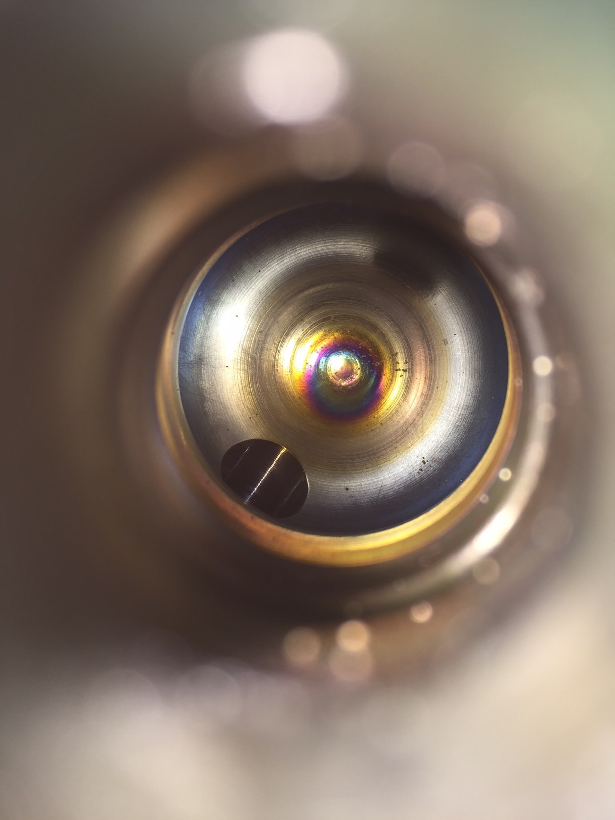

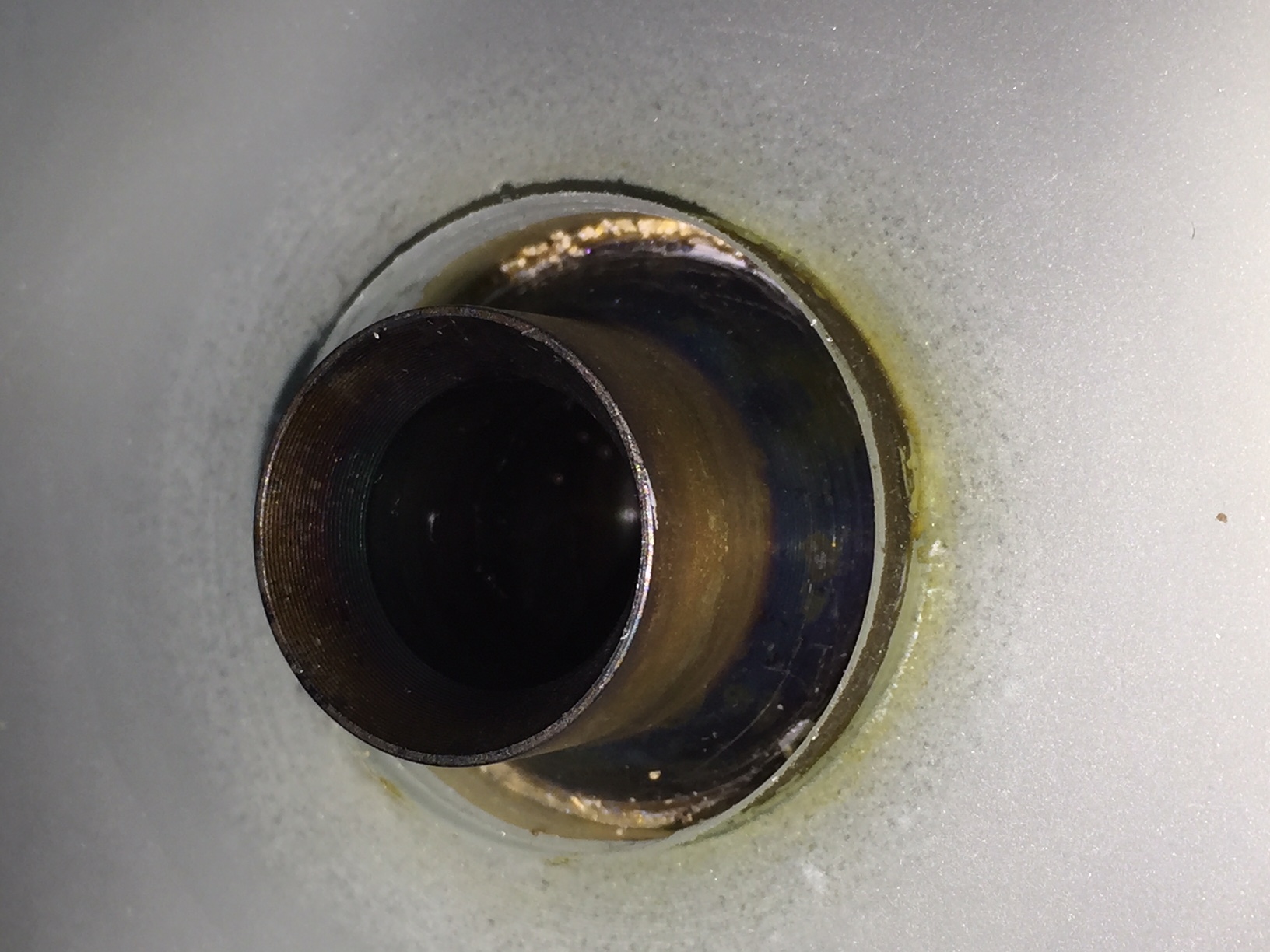

After running the FICS reactor for many hours with mixed results, I decided to crack it open.
It was generating neutrons but the TIER was in the low high 10^4 low 10^5 range, and it should have been doing a lot more than this. I suspect the 6" cathode chamber was too large and that too many ions failed to circulate through the chamber, making it near impossible to keep the plasma lit. Hindsight is much brighter than foresight :)
On a positive note, this chamber held vacuum really well, it would only drop by around 20 microns a day, which is pretty impressive when you consider how many layers and seals it has. Also surprising how I was able to separate the cathode from the glass disc with relative ease. Just a few squirts of acetone and a gentle lever action made the latex glue come apart.

I have already started making a new cathode, this one will only be 30 mm thick, and will incorporate a neodymium ring magnet in the centre. The two accelerator tubes will almost come together face to face, allowing for easy ion transition through the hole. the actual cathode will not have any metal protruding into the chamber, thereby making it impossible for ions to strike the cathode directly and release secondaries.
