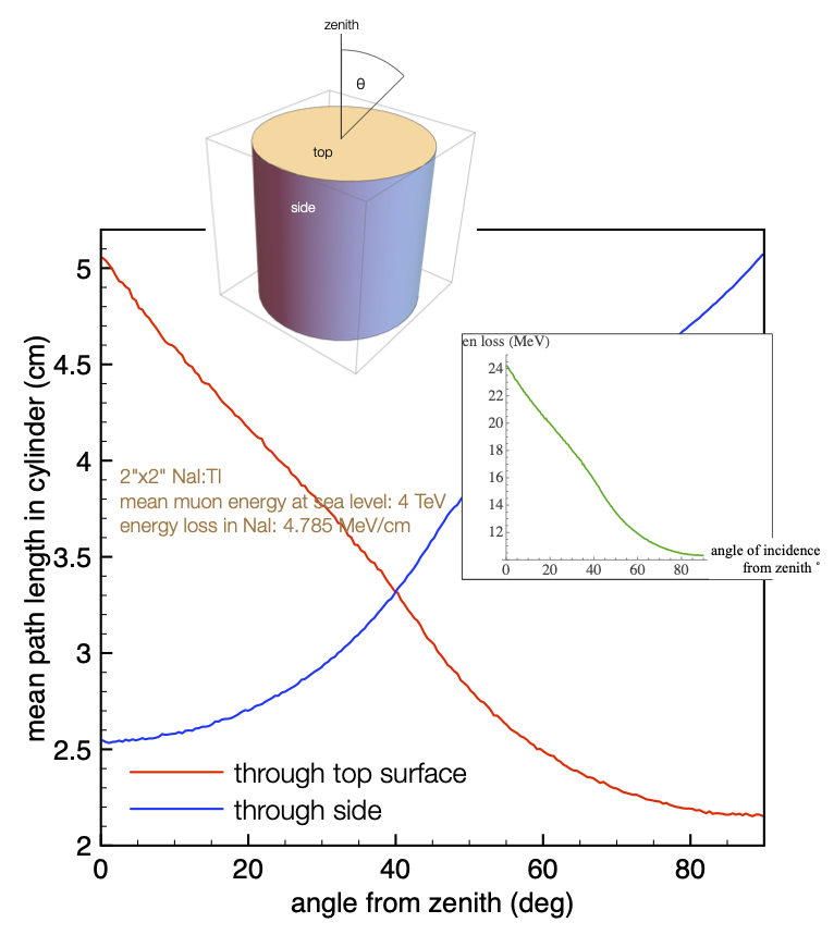

Re: What would a muon (cosmic ray) peak look like?
Magnus and Bob,
Thanks for your notes!
My understanding at present is that muons (produced at the top of the atmosphere) are prodigiously more energetic than gamma rays and have a range of energies (GeV up to hundreds of TeV), average about 6 GeV. You can see in background count rates with a Geiger-Muller counter the seasonal variation in the muon flux--in the summer the top of the atmosphere is further from the surface due to thermal expansion, and fewer muons reach the surface. (That they make it at ALL, given their finite lifetime, is a relativistic effect: time dilation or length contraction depending on your preference.)
In NaI they lose energy at a rate of 4.785 MeV per cm. Naturally depending on the angle of incidence on the scintillator there is a range of traversal distances. I wrote a quickish Fortran program (thanks chatGPT!) to do a Monte Carlo calculation. The figure shows the AVERAGE path lengths traversed (I *should* have computed the distribution too) and the inset shows the energy loss of the muon in MeV for this range of path lengths.
This predicts energy losses of from 10-25 MeV in NaI:Tl. I'm not sure how to reconcile all the data shown above.
