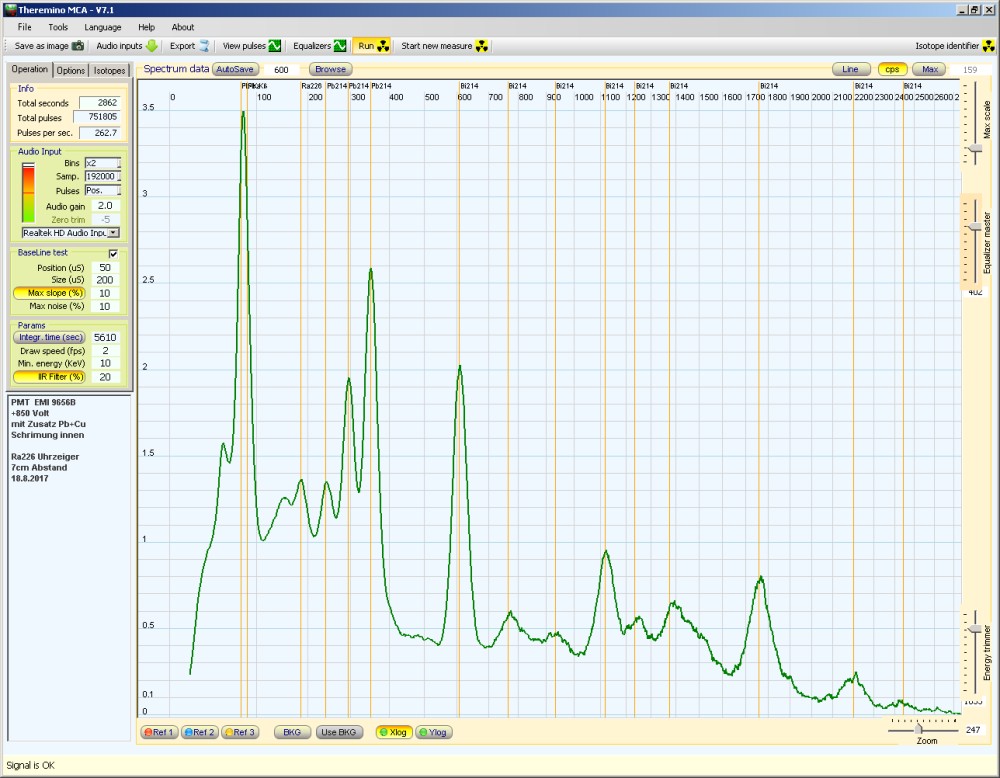

Hi,
I think it will be best if you take an old clock with luminescent hands. There are very many lines to control the system.
http://fs1.directupload.net/images/171214/c4g69shz.jpg
