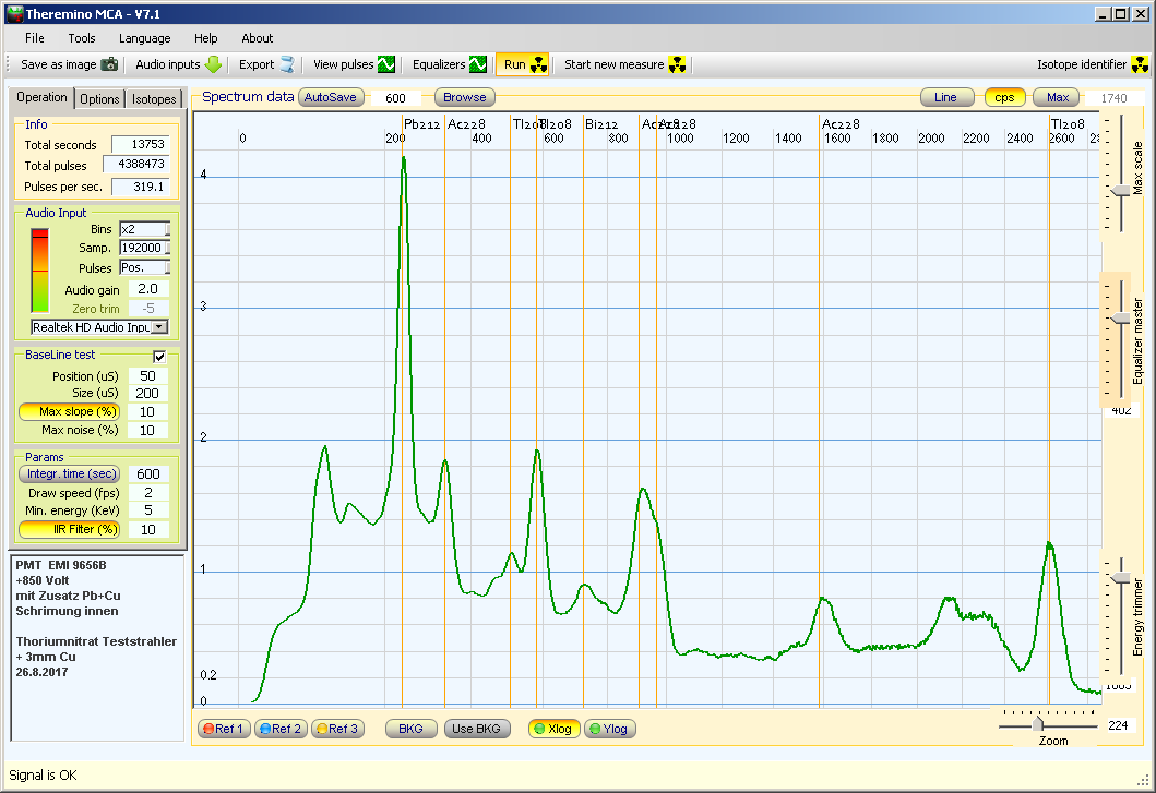

Re: CS-137 Spectrum, new shield
In my opinion, is a testprobe with Th the best choice. Then you are sure to see the spec up to 2600 keV.
http://fs1.directupload.net/images/171215/wywyfun3.png
