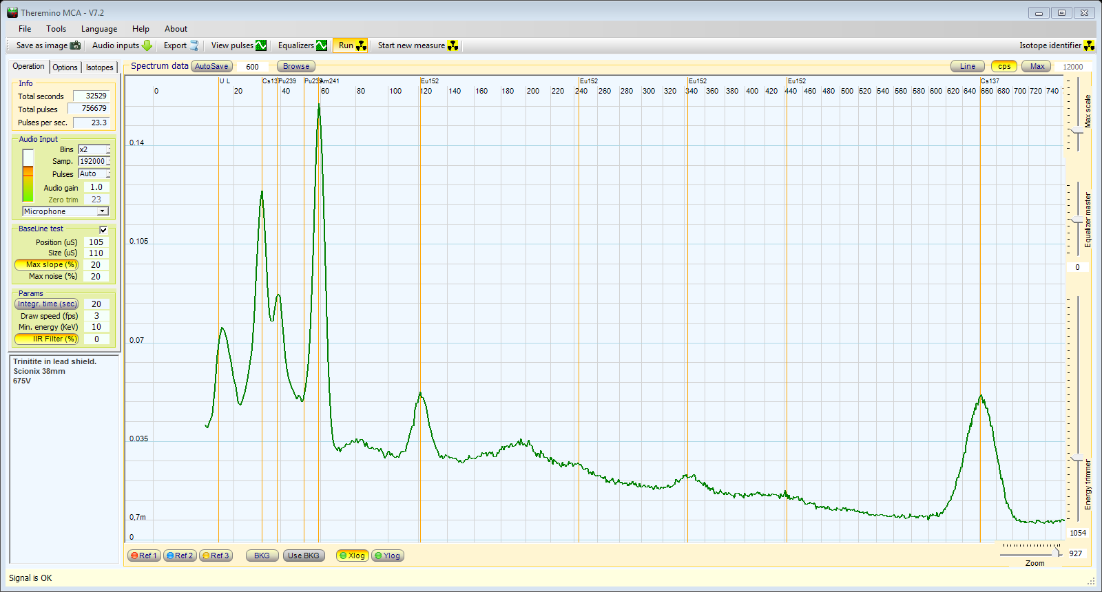

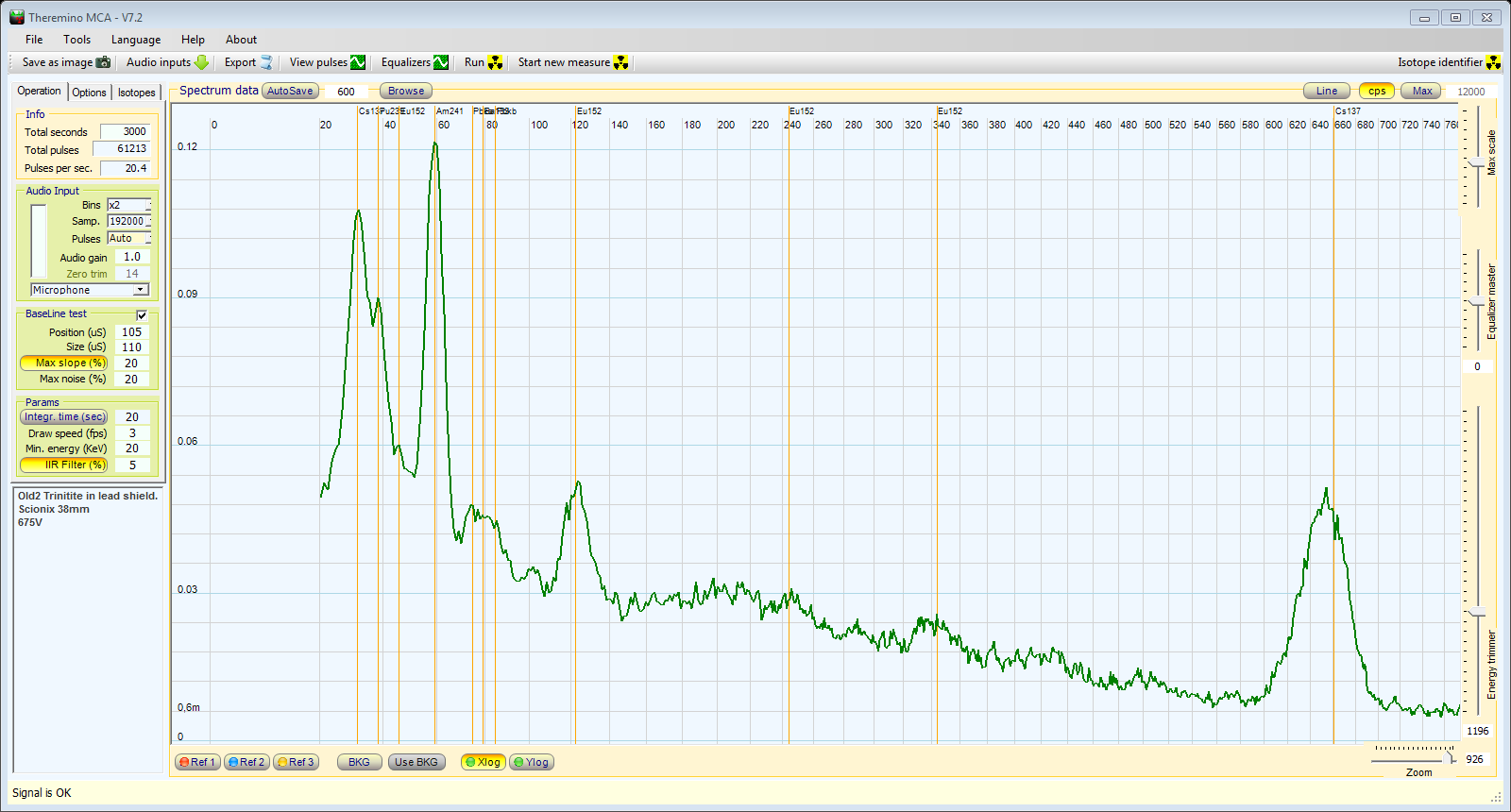

We may never know for sure, but I believe the broad peak you identified at 80 keV, is most probably the various isotopes identified in the Pittauerova paper, including Ba133. I’m no expert, but in my limited experience, lead florescence is a lopsided, elevated region between 75 keV (K alpha 1) and 85 (k beta2), with the 75 keV end dominating.

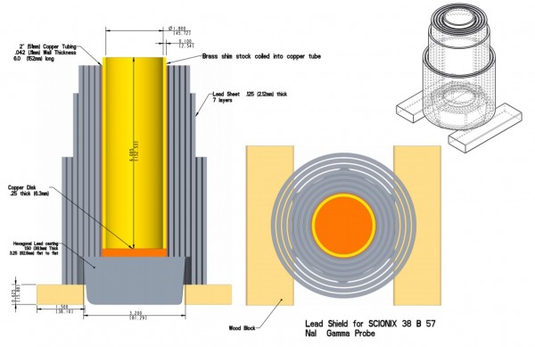

When I first built my shield, I used Trinitite as my subject and I had considerable lead florescence. I added more and more material in the inner core, and that area leveled out and disappeared. In the end, I had a broad peak, centered at 80, much like yours. The first two spectrums below are of Trinitite , first and last, as I improved my shield.

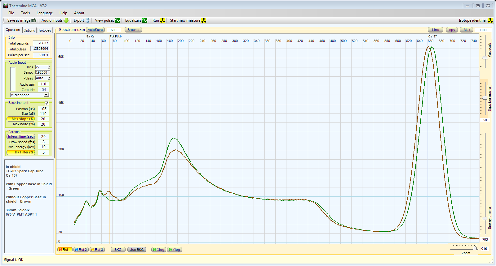

The last spectrum is of a Cs137 source in my shield, with and without the copper disk that serves as a floor to the shield. I did this to intentional create a Florescence peak for reference. Note the shape.

I just bought some more pewter which will allow me to double its thickness in my graded shield, so my next attempt will be with about 9 mm of pewter instead of 4-5 mm, that should further reduce fluorescence and it'll be interesting to compare results between spectra recorded with the two versions of the shield.
