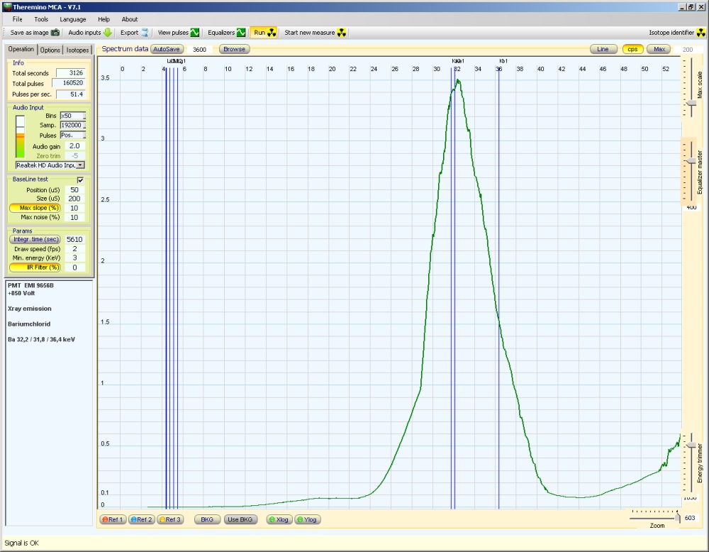

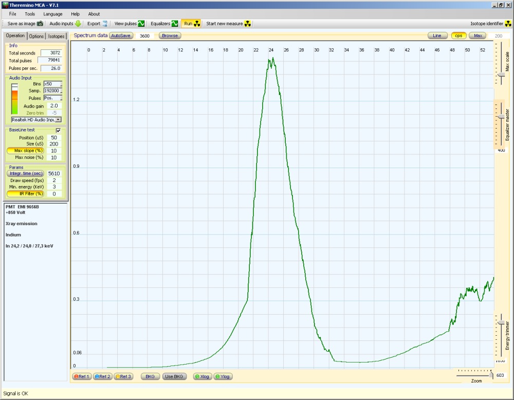

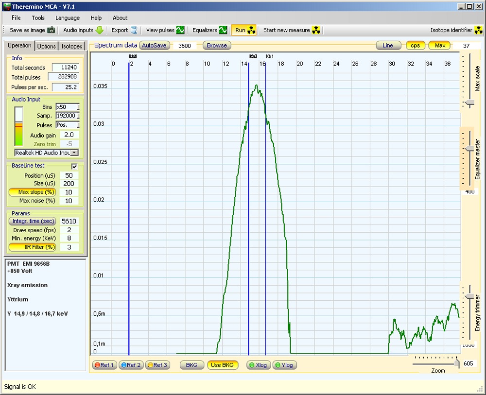

to check the linearity of my system in the low region I test it with the X-ray fluorescence. Stimulation is a small Am241 emitter.
Barium for 31.8 32.2 and 36.4 keV
Indium for 24.0 , 24.2 and 27.3 keV
Yttrium for 14.8 , 14.9 and 16.7 keV
I think this is a simple test and works well.
