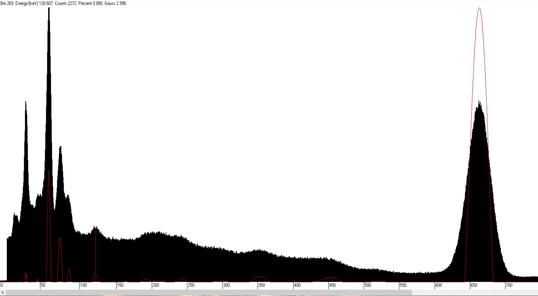

Well, I got burned on this one. I bought a "certified authentic" piece of Trinitite a few months ago and just tested it yesterday. Attached is the 24 hour spectrum with background subtracted.
Fake Trinitite Spectrum

Ouch, it looks like typical U ore. Trinitite has dominant peaks from Cs-137 and Am-241, with lots of little peaks from Eu-152, -154, and other nuclides. I can post a couple of papers in the library that show the spectrum from trinitite.

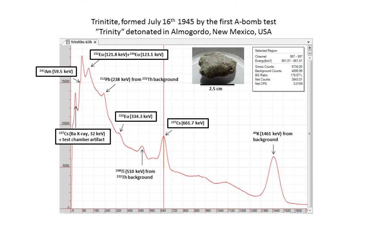

Hi Geoff,
That sucks... I bought my trinitite sample via a contact from the Yahoo forum, so it was kind of failsafe. I could also verify that it was indeed trinitite.
Still, the 3x3" probe I used picks up lots from the background as well and the trinitie sample was weak, so a smaller probe and more lead could possibly be more informative. I hope to be able to test this in the time to come.

Karl Brehwens

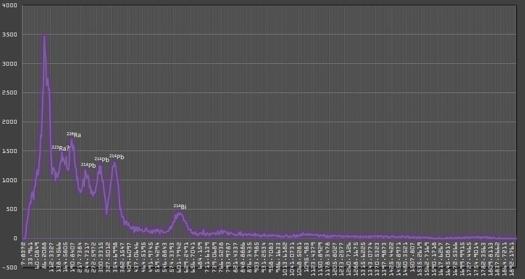

Re: Fake Trinitite Spectrum
I used my 4.5x.75 inch NaI detector and ran it for 24 hours. Then I ran the background for 24 hours and subtracted that to get my spectrum.
Here is all the data
