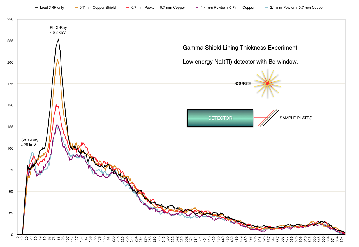

I set up a low energy X=Ray detector facing a sample sheet of lead at 45˚ angle with a Cs137 source perpendicular to the detector and shielded so there were no incident gamma directly hitting the detector, only the Pb plate, and recorded a 1 hour spectrum.
The experiment was then repeated using a sheet of 0.7 mm copper in front of the lead, and again with 0.7 mm copper and 0.7 mm ti, and again with two sheets of tin and finally three sheets of tin.
Conclusion
What I discovered was that copper alone is a poor attenuator of 80 keV x-rays and with one layer of 0.7 mm Cu, I achieved an 11% reduction.
Adding just one layer of Sn (Pewter) 0.7 mm between the copper and the lead gave a much better 33% reduction in x-rays
A second layer of tin improved it further and reduced the x-rays by 45%.
Based on this experiment I would project that a reasonable lining to aim for would be around 2-3 mm of Pewter and 1-2 mm of copper.
