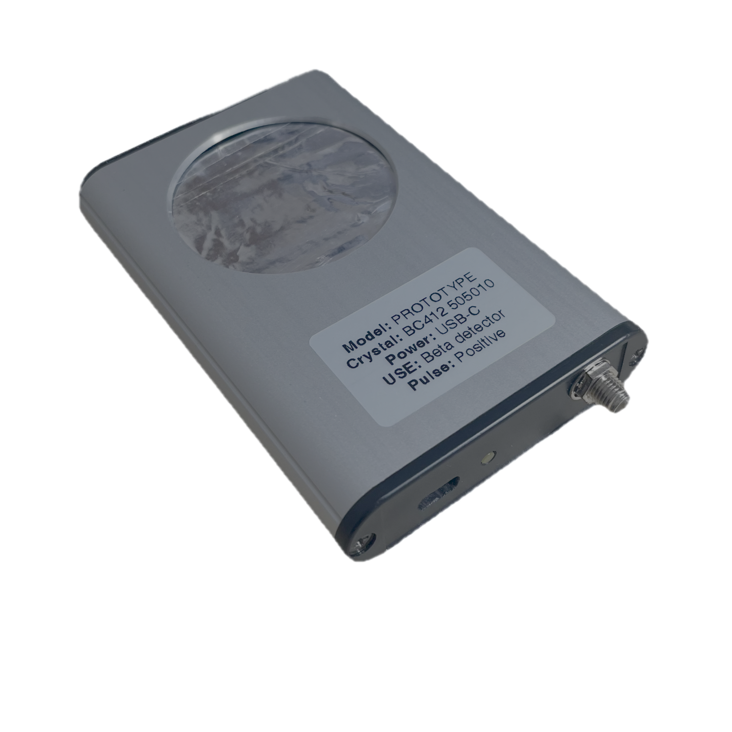

This beta particle detector is a one of a kind prototype, it has a 50 x 50 x10 mm BC412 scintillator with SIPM and preamplifier. The device is powered by USB and outputs a pulse via the SMA connector. The detector comes with an instrument case USB cable and SMA cable.
Several of these custom devices were recently made made for a University research project and this was our prototype.
External dimensions: W 71 mm - L 108 mm - D 19.05 mm

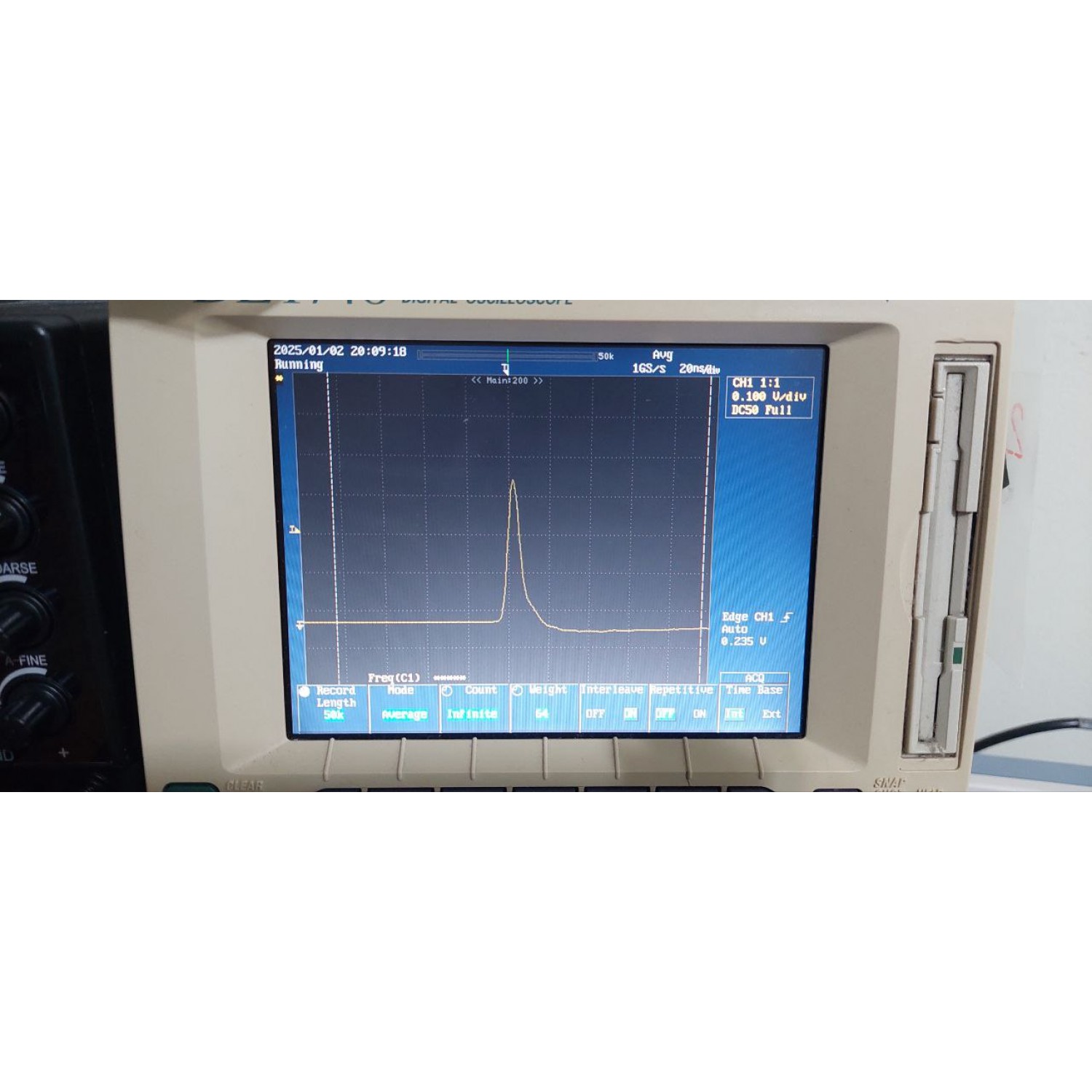

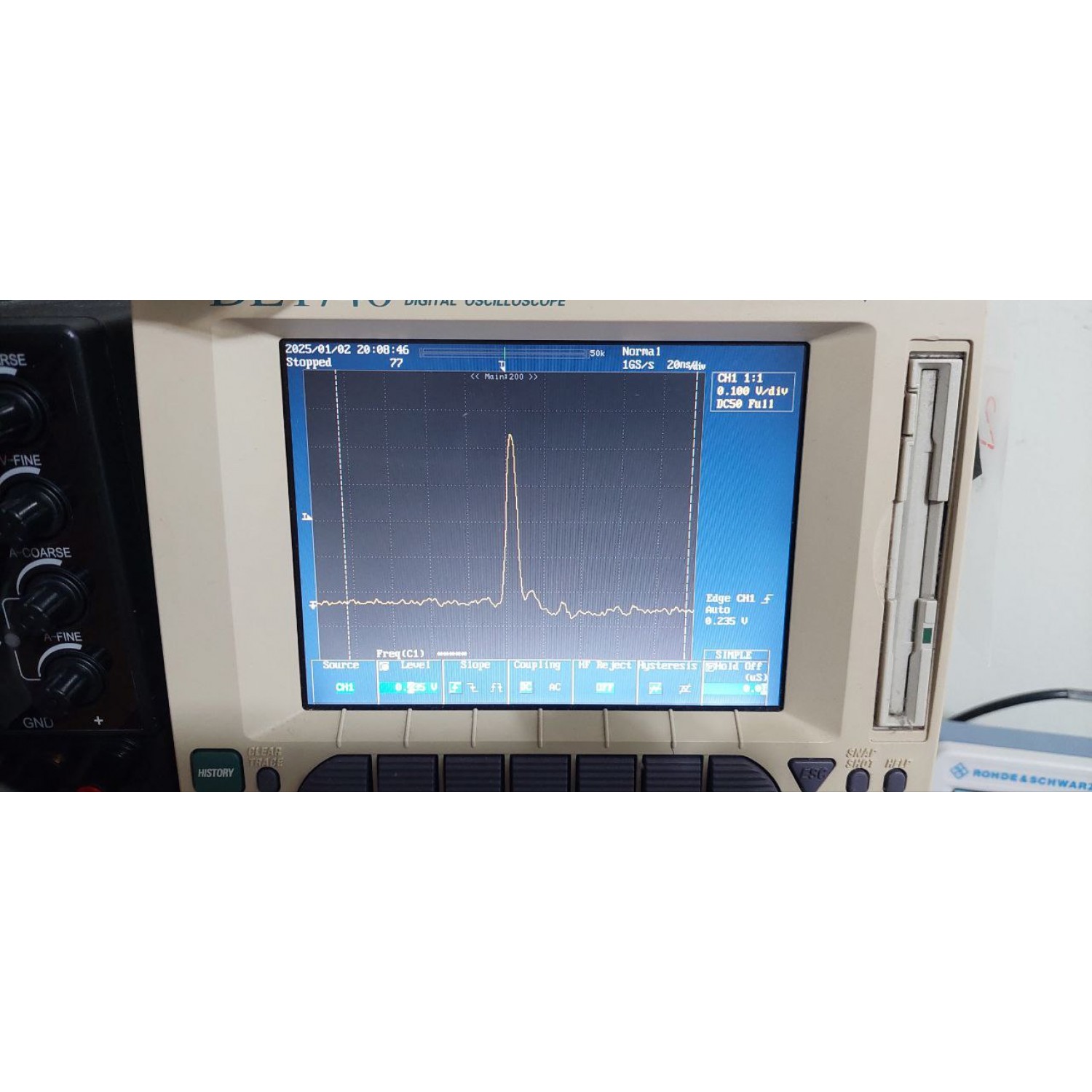

I attach some images of the pulse shape and height.
