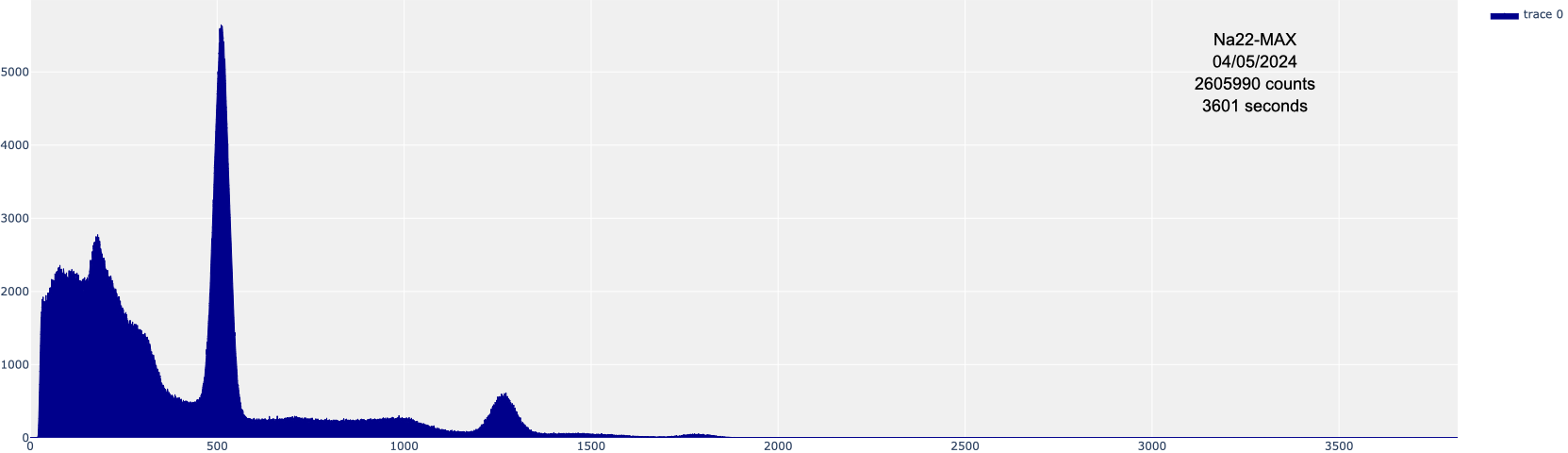

Na-22 Gamma Spectrum
Below is a one hour spectrum of Na-22 recorded with a GS-MAX-8000 and GS-1515-NAI detector. The spectrum shows a strong electron-positron annihilation peak at 511 keV with the main photo peak peak being the smaller one on the right.

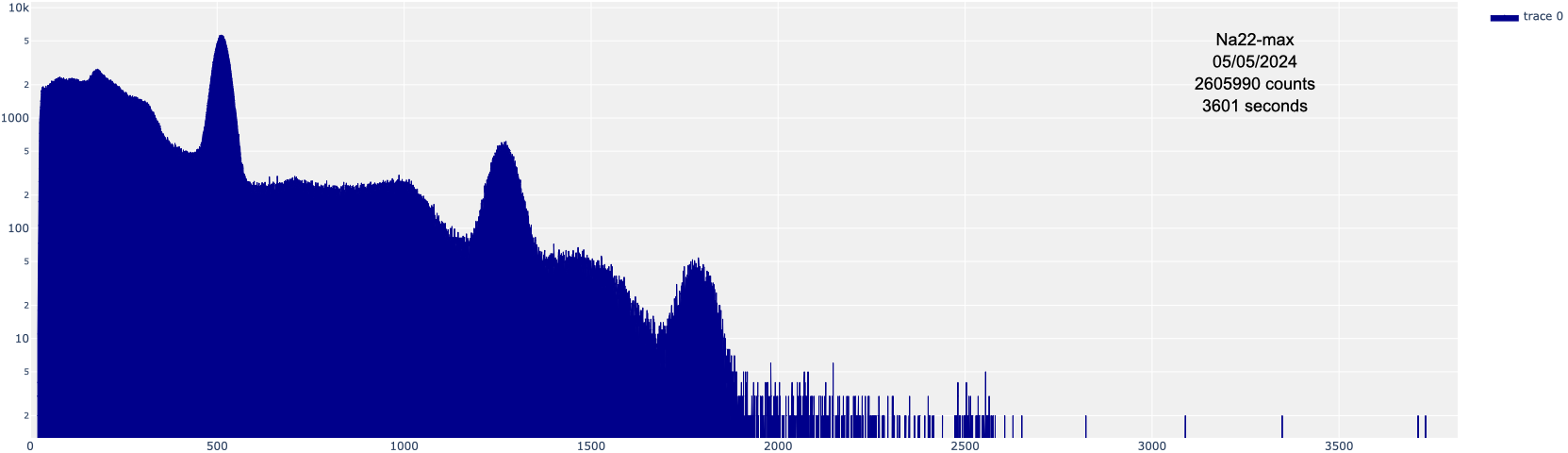

22-Na Gamma spectrum log scale
Gamma (keV) Intensity in %
510.99 (pair production)
1274.53 99.944
1785.52 Sum peak
