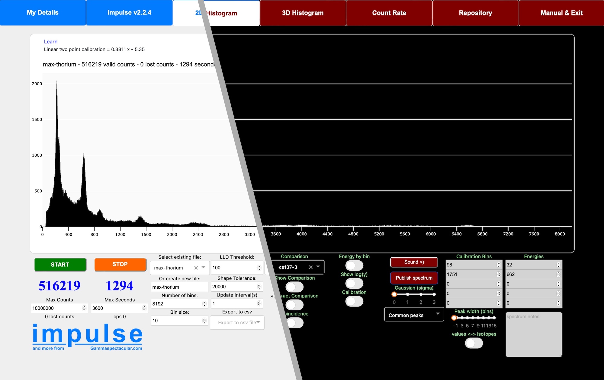

Tab-2 Pulse Height Histogram
Tab 2 displays the pulse height histogram plus a number of additional settings relevant to this page. Most of the buttons and fields are self explanatory, but for a more detailed explanation you may click on tab-4 where you find the full manual.
Summarising the main functions on tab-2.
  • Pulse height histogram
  • Start/Stop function
  • Total counts and cps
  • File name input (saves to NPESv1.0 format)
  • Number of bins (width of spectrum)
  • Size per bin
  • Stop condition
  • Lower Limit Discriminator LLD
  • Shape tolerance (from tab-1)
  • Comparison spectrum (select any previously recorded spectrum as comparison)
  • Isotope library - Show peaks from any one of 480 isotopes
  • Comparison spectrum overlay
  • Subtract comparison spectrum
  • Rescale y axis as , log or energy per bin
  • Play a 3 second audio of selected spectrum
  • Three point calibration with second order polynomial fit
  • Peak finder
  • Gaussian correlation
