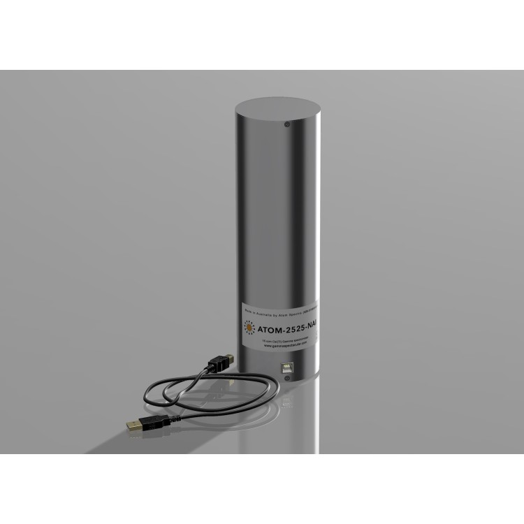

Digital Gamma Spectrometer with 2.6" x 2.6" (64 x 64 mm) NaI(Tl) Crystal
Fully integrated USB spectrometer with fast PMT counting circuit in a precision machined enclosure. The large spectrometer connects to a PC, Mac or Android smartphone and sends spectrum data via USB UART serial connection to the device.
ATOM-2525-NAI offers true plug and play spectrometry, it could not be much simpler. The Software which is FREE and open source provides a powerful interface with magic features like background subtraction and isotope libraries to help you identify peaks.
This sensitive detector and associated electronics is housed in a precision machined and anodized aluminium housing with LED to indicate power and recording.
The ATOM-2525-NAI detector has internal temperature sensor to compensate for temperature drift over a wide range from -40C˚ to +80C˚

    Scintillation Crystal 63 x 63 mm NaI(Tl)
    Resolution < 7.5%
    Power consumption < 1 Watt
    Weight 1475 Gram
    Max cps. >100,000
    Dimensions 81 x 260 mm
    Temperature operating range -20 to +60 C˚
    Channels 8192
