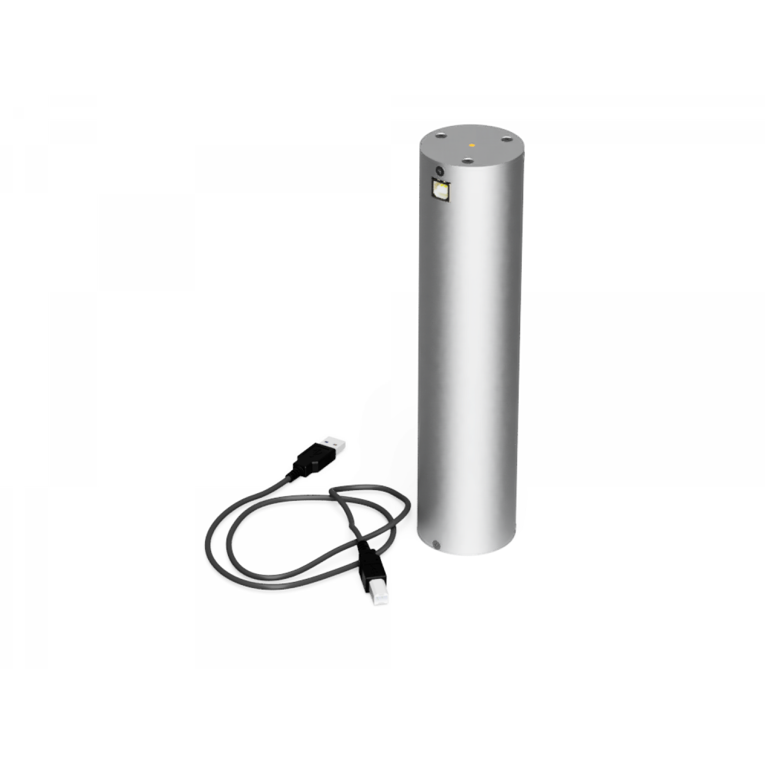

Digital Gamma Spectrometer with 1.6" x 1.6" (40 x 40 mm) NaI(Tl) Crystal
Fully integrated USB spectrometer with fast PMT counting circuit in a convenient package. The hand held spectrometer connects to a PC or Android smartphone and sends spectrum data via USB UART serial connection to the device.

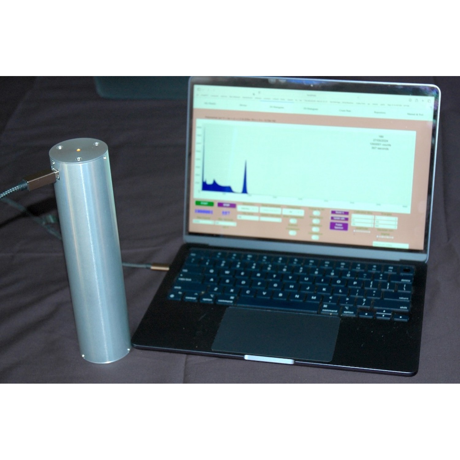

ATOM-1616-NAI offers true plug and play spectrometry, it could not be much simpler. The Software which is absolutely FREE and open source provides a powerful interface with magic features like background subtraction and isotope libraries to help you identify peaks.

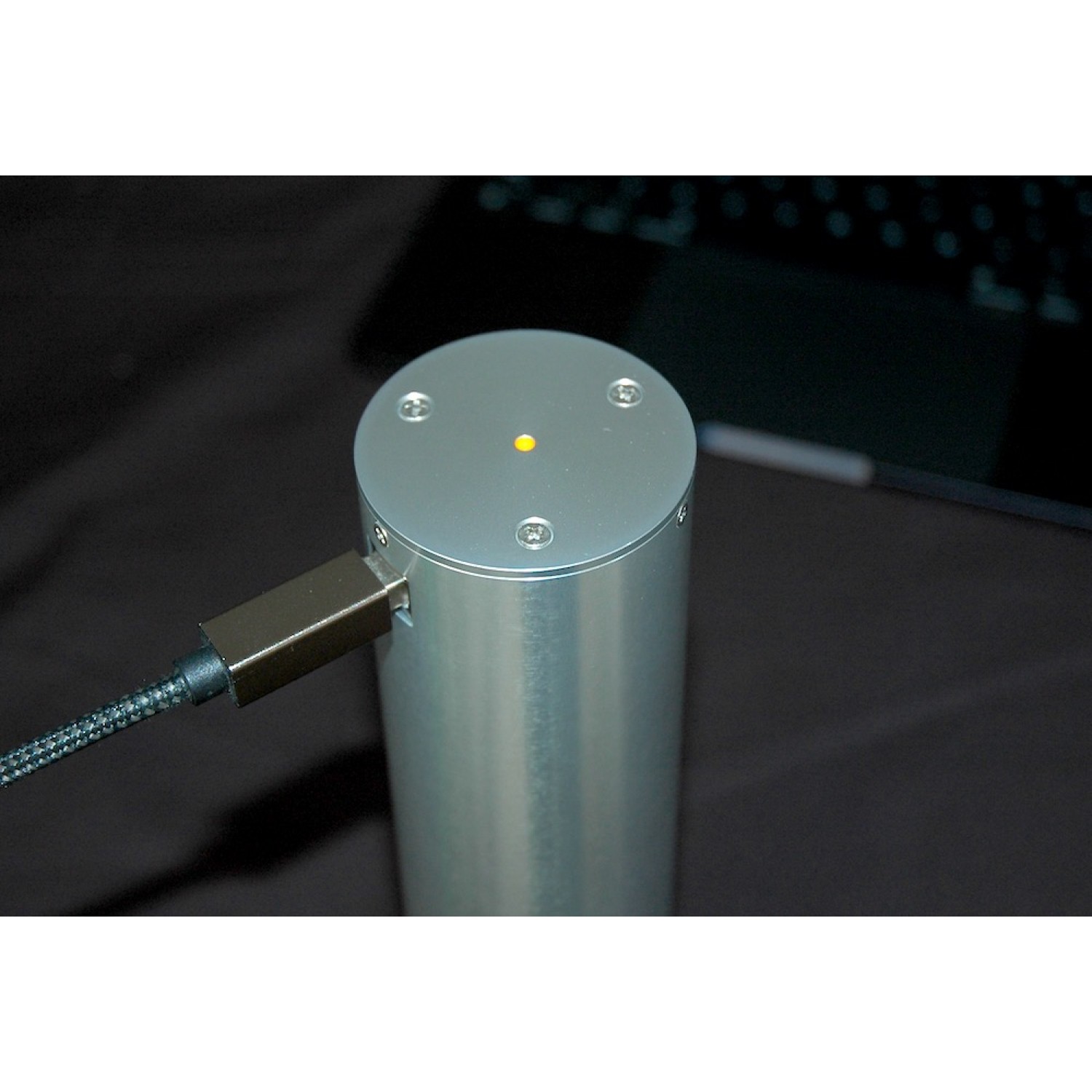

The sensitive detector and electronics are hosed in a precision machined and anodized aluminium housing with LED to indicate recording.
The ATOM-1616-NAI detector has integral temperature sensor to compensate for temperature drift over a wide range from -40C˚ to +80C˚
Download ImpulseQt [PC+MAC]
Compatible Software
  • BecQmoni Atom [PC]
  • ImpulseQt [PC + MAC]
  • Atom-Spectra [Android]

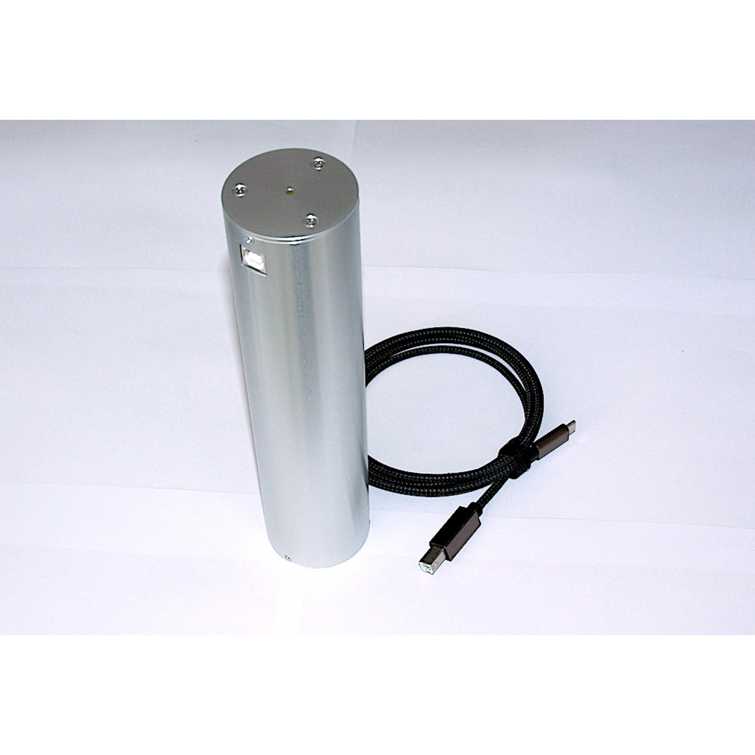

  • Includes
    1 x ATOM-1616-NAI
    1 x USB Type-B to Type-A cable
    1 x USB Type-B to Type-C cable
    1 x Instrument case
    Scintillation Crystal 40x40 mm NaI(Tl)
    Power consumption < 1 Watt
    Weight 583 Gram
    Max cps. ~100,000
    Dimensions 55 x 235 mm
    Temperature operating range -20 to +60 C˚
    Channels 8192
