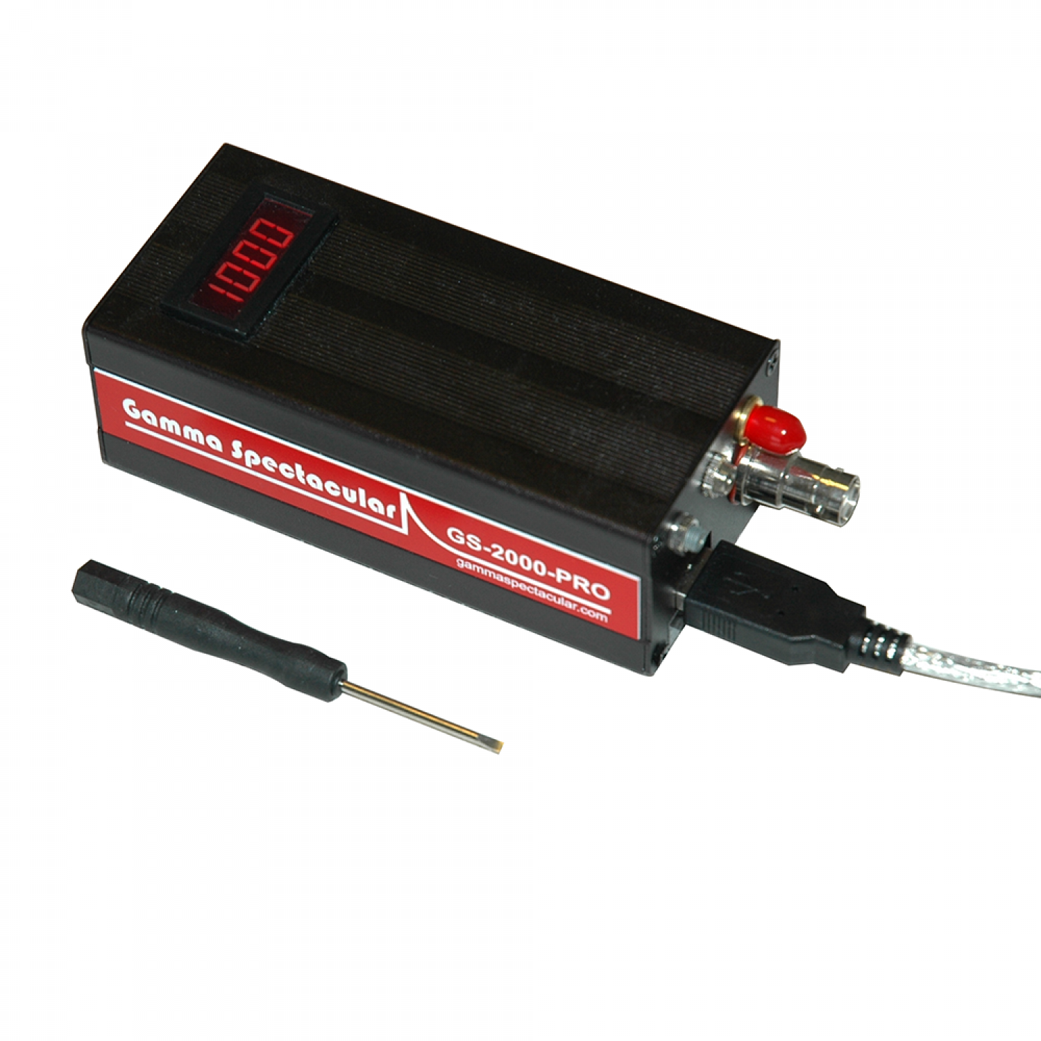

This model is exactly the same as the GS-1100-PRO with the only difference being the maximum bias voltage and the SHV connector which is rated for higher voltage.
The wider voltage range makes this driver suitable for gas proportional counters, neutron detectors, and special scintillation crystals with low light output, so for an educational physics lab or a research institution, this one might be the better choice.

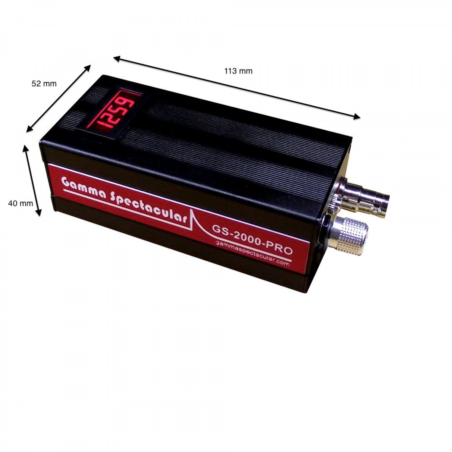

GS-2000-PRO Technical Specifications
Input Power (USB) + 5V
Current Draw < 200 ma
Output Bias Voltage (smooth potentiometer) 0V to 2000V
Output Signal (Audio Line Level) + 0 - 2500mV
Pulse length 100 µs
Preamp Gain (adjustable trim pot on bord) set to ~10%
Ripple  < 1 mV
Voltage Drift <1:1000V

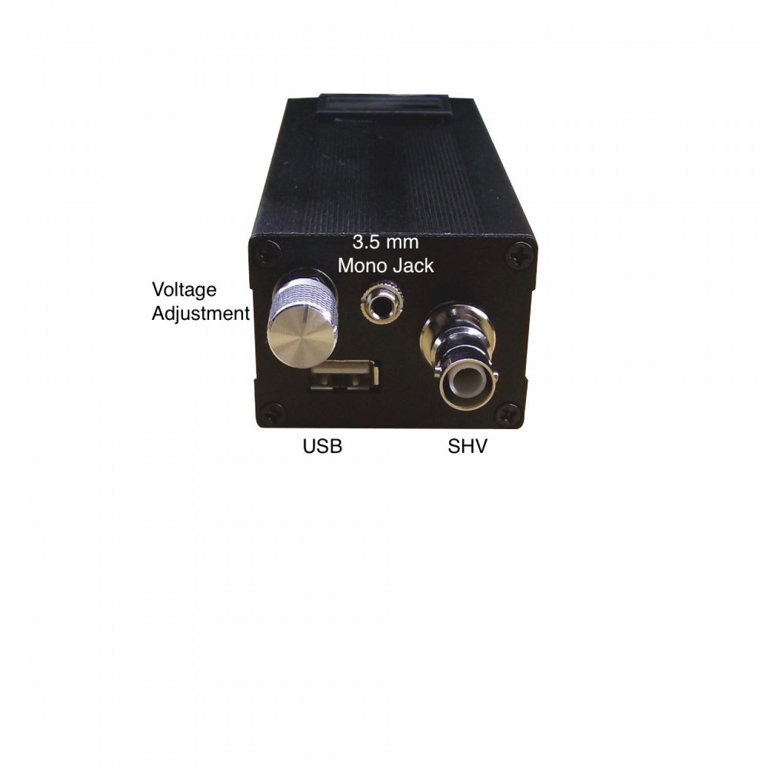

High Voltage Connector SHV
Signal input connector SMA
Audio line level signal output 3.5 mm mono jack

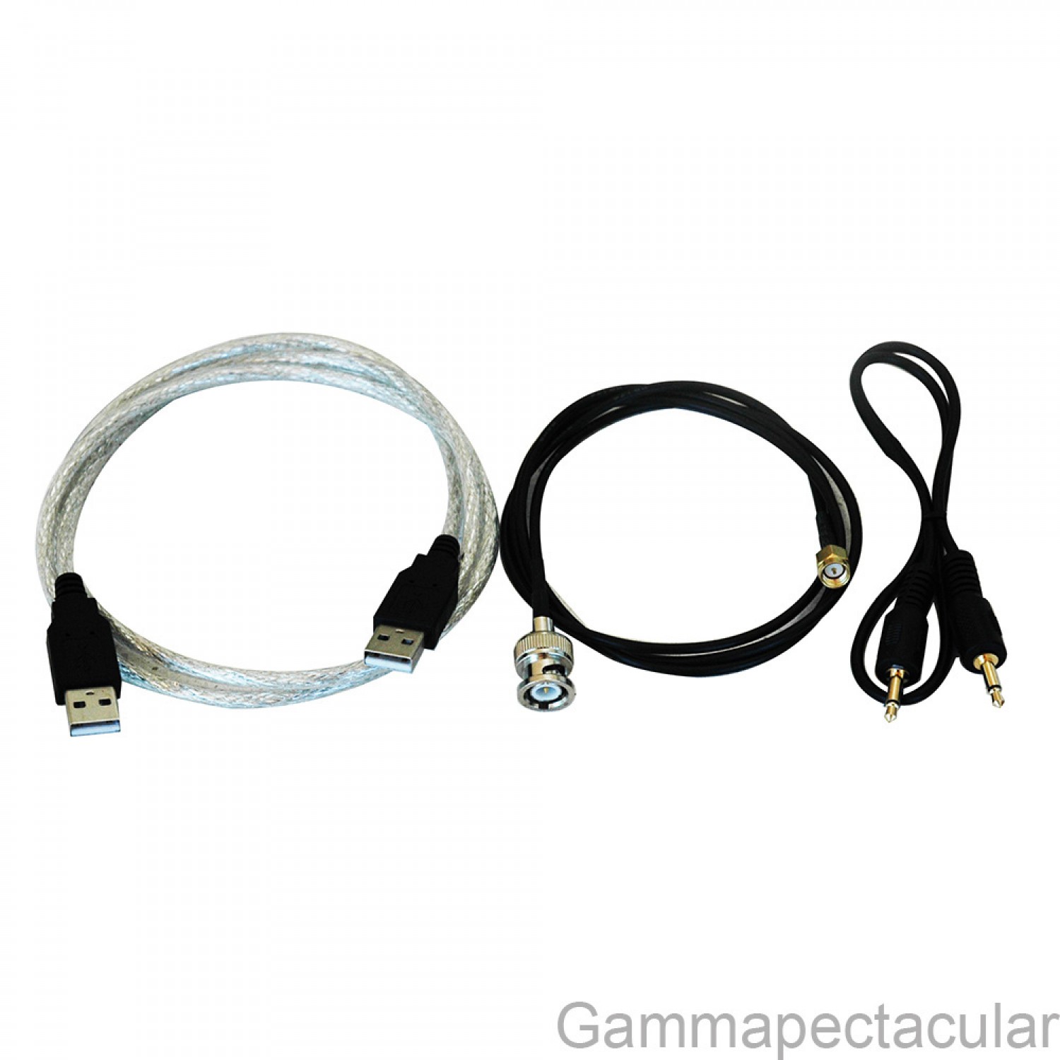

Includes:
1 x USB Cable
1 x 3.5 mm mono jack cable
1 x SMA to BNC Cable
