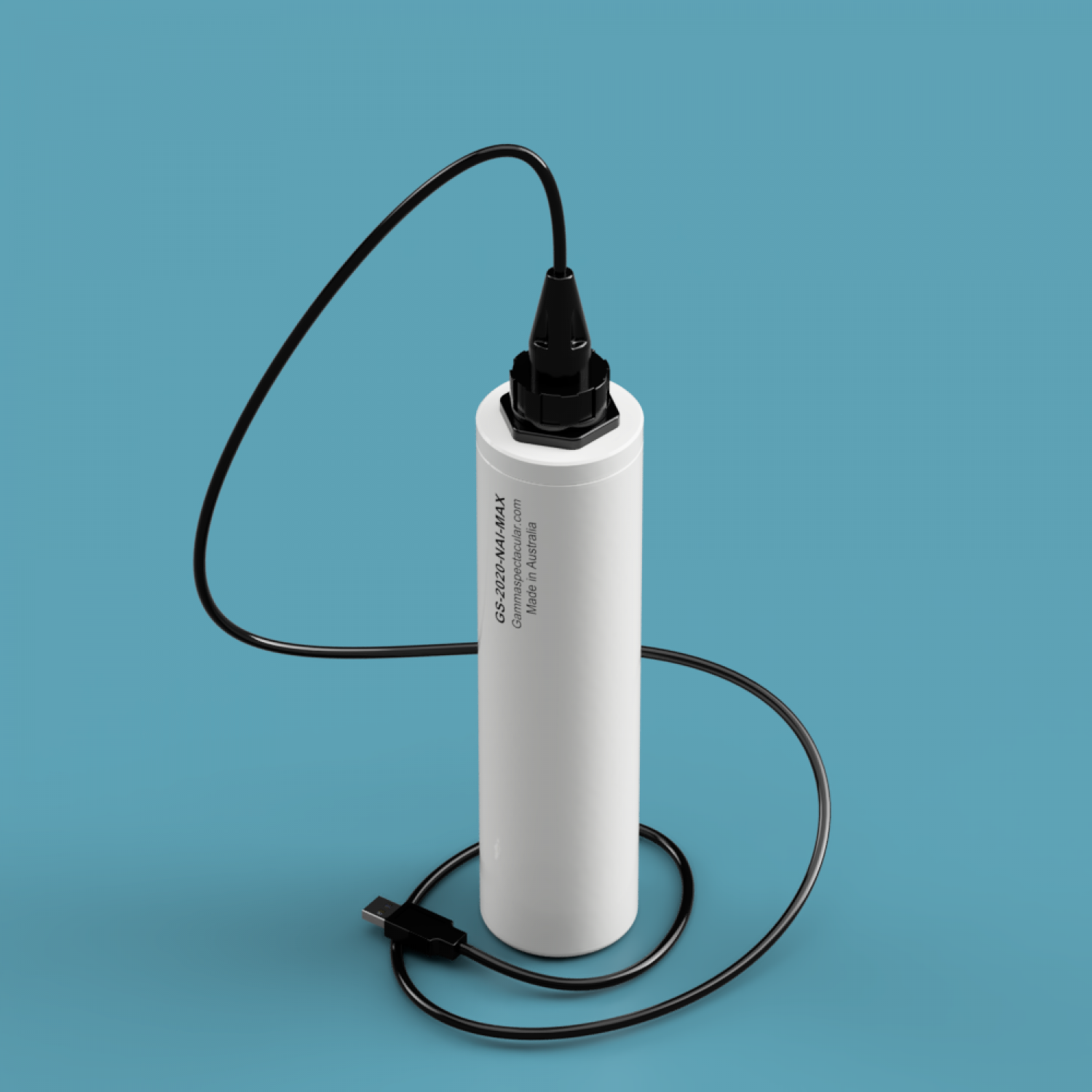

The GS-2020-CSI-MAX is a 2x2" CSI(Tl) detector with integral high speed spectrometer, this detector can count up to 100,000 cps with excellent resolution < 7%.

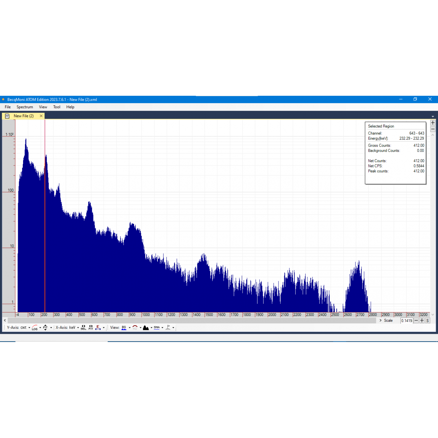

It connects directly to a PC and works with free open source software called Becqmoni.
The GS-2020-CSI-MAX detector has integral temperature sensor to compensate for temperature drift over a wide range from -40C˚ to +80C˚

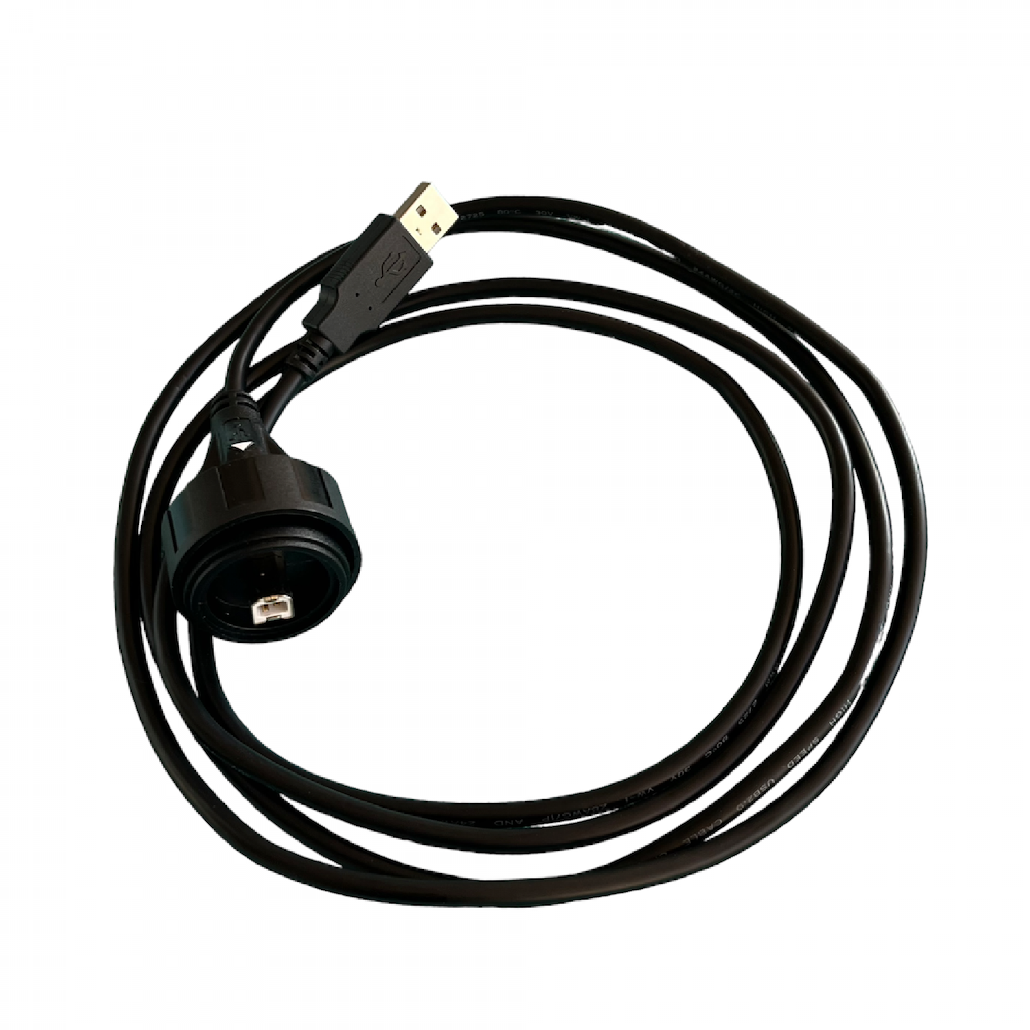

1 x Water resistant USB cable 2.0 meter

USB Cable length 2 meter

Max Channels 8192
