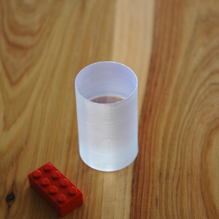

Cylinder shaped plastic scintillator to fit 1.5" PMT, rough sanded on the sides with shiny clear ends.
This scintillator is sensitive to gamma radiation and is great for high efficiency counting experiments.
Plastic scintillators have poor pulse height resolution and are not ideal for spectrometry.
