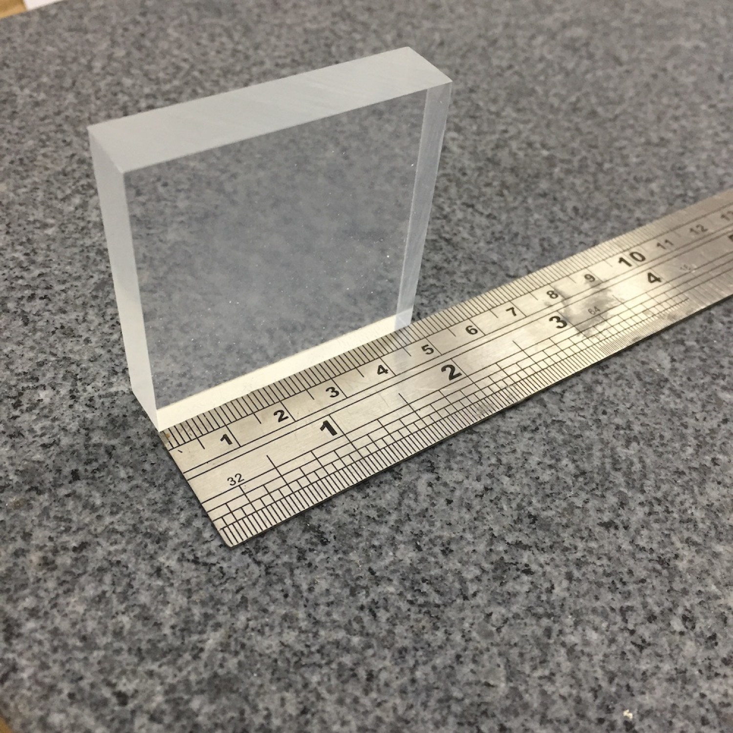

• XL-BC412-505010 Plastic Scintillator
One piece of BC412 plastic scintillator 50 x 50 x 10 mm suitable for cosmic ray experiments.
Property
BC-412
Light Output, %Anthracene
60
Rise Time, ns
1
Decay Time (ns)
3.3
Pulse Width, FWHM, ns
4.2
Wavelength of Max. Emission, nm
434
Light Attenuation Length, cm*
210
Bulk Light Attenuation Length, cm
400
Atomic Composition
No. H Atoms per cc (x1022)
5.23
No. C Atoms per cc (x1022)
4.74
Ratio H:C Atoms
1.104
No. of Electrons per cc (x1023)
3.37
