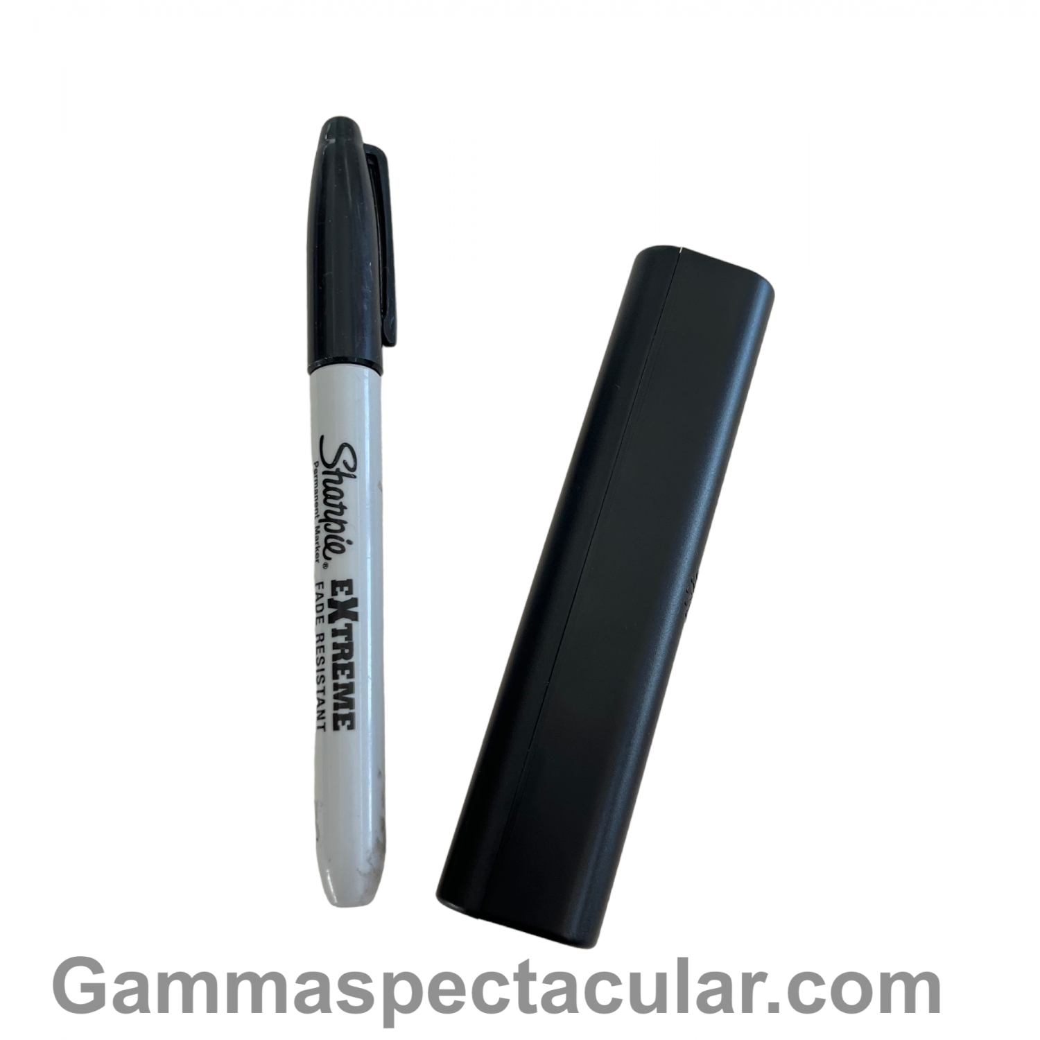

 Size  |
 120*20*12 mm (4,7" x 0,78" x 0,47")  |
 Weight  |
 45 g max (1.6 Oz max), 55 g max (with 7.5 x 7.5 x 100 mm CsI crystal)  |

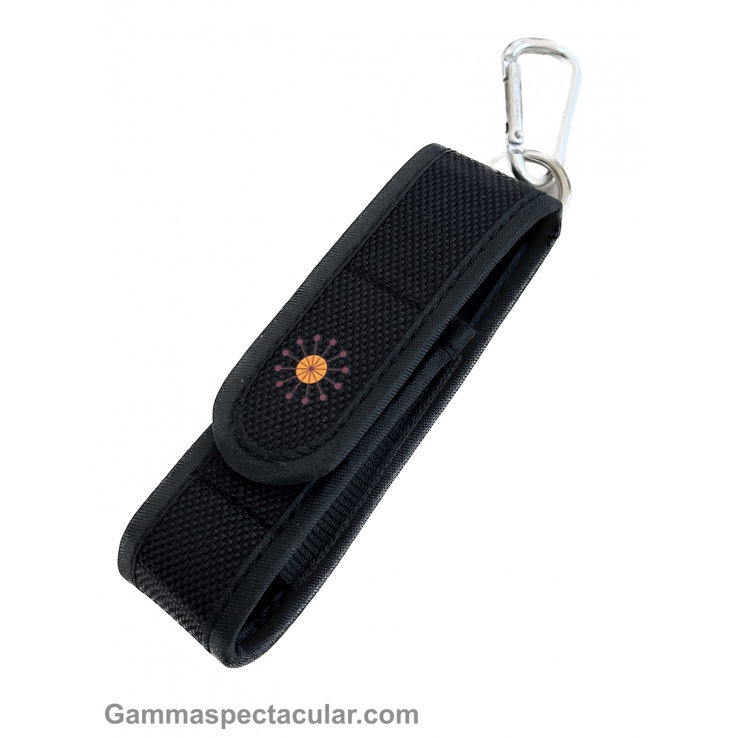

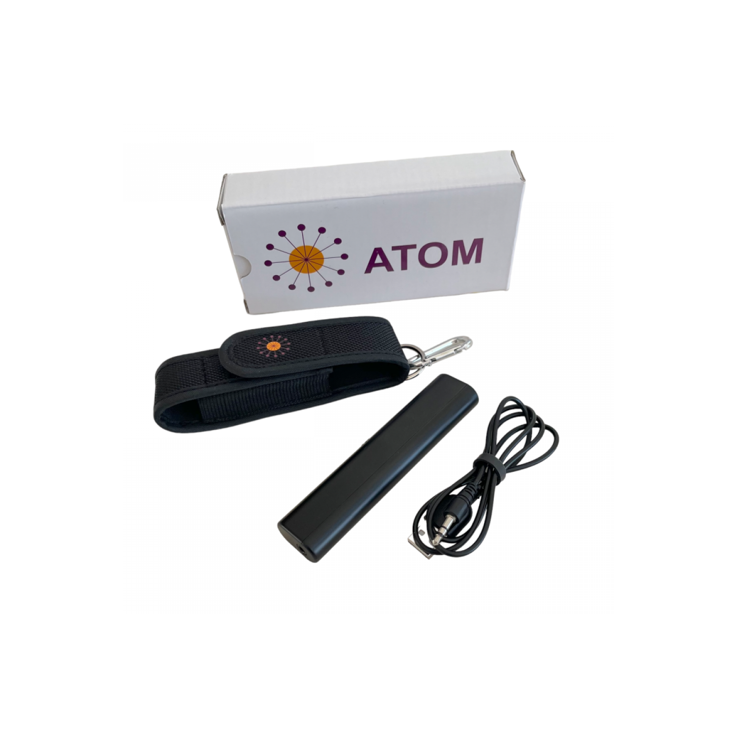

- Atom Fast radiometer-dosimeter
 - USB charging cord
 - Nylon carrying case
 - Paper Box

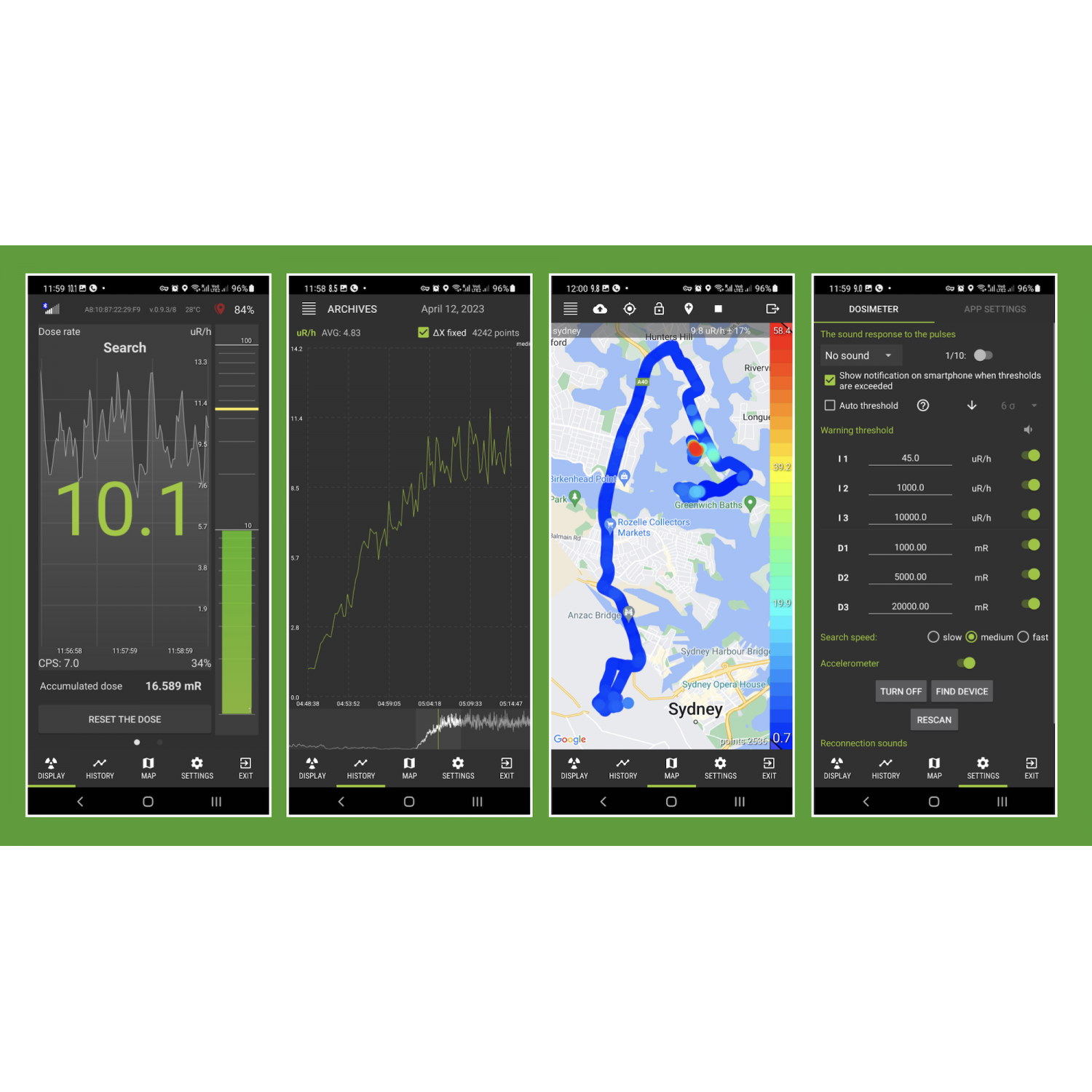

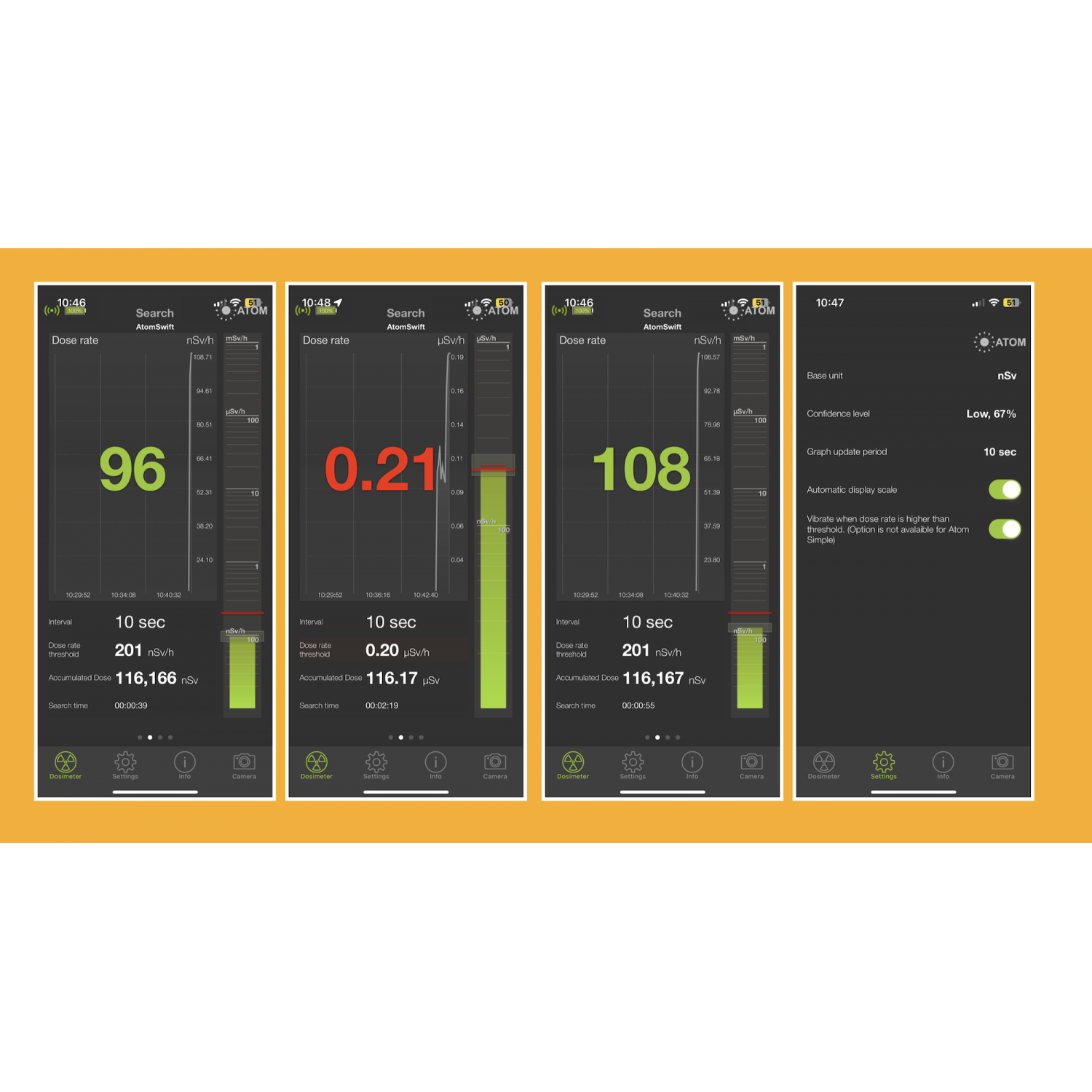

Your Atom Fast can work in two main modes: search mode and measurement mode. Toggling of these modes can be done in the application you use. If your smartphone switched to sleep mode communication with Atom Fast is still alive and started measurements are still in progress.
Search mode.
In search mode reaction to radiation dose rate change is fast in expense of measurement accuracy. You can select between “Fast”, “Balanced” and “Accurate” search modes in application settings according to your needs. In search mode data from the sensor is analyzed using sliding window method, time to first reading is less than 5-10 seconds in “Balanced” search mode under normal radiation background (0,1 uSv/h or 10 uR/h). After first reading indicated it will be updated every two seconds. Search mode is recommended for checking of land, vehicles, construction materials etc.
Measurement mode.
In measurement mode Atom Fast gathers information from the scintillation detector all the time until manual reset button will be pressed and indicates current statistical error which decreases with measurement time. You can start new measurement any time by pressing “Reset” button on the measurement screen. Measurement mode is suitable for detecting very low activity sources by comparison of two dose rates: background dose rate and dose rate close to possible source of radiation. Don't move your Atom Fast during measurement to get most accurate readings. Please note that statistical accuracy increases by square root law: you need to make four times longer measurement to get twice accurate result.
Settings.
The application lets you choose between measurement units, set dose rate and accumulated dose alarm level and many other parameters. We work on improvement of our applications, new features are added regularly. Please keep application up to date.
