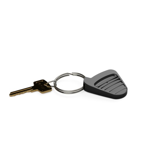

Atom Swift is a compact keychain radiation dosimeter designed to work with a smartphone or tablet PC. It is capable of detecting and measuring low-level Gamma, X-ray, and Beta radiation. Alarm thresholds can be set by the user.

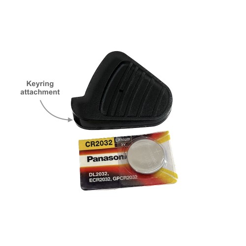

Atom Swift contains an ultra-sensitive scintillation crystal detector (CsI crystal and silicon photomultiplier) capable of detecting low-energy gamma and X-rays.

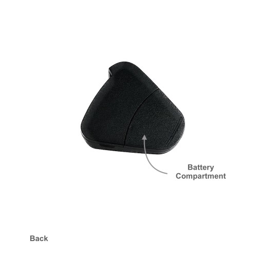

The detector and associated electronics are housed in a robust polycarbonate housing, small enough to hang on a keyring, and powered by one CR2032 lithium battery.

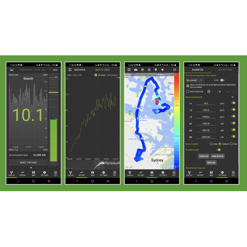

Free apps are available in the App Store (iOS) or Google Play (Android). The app processes information gathered from the scintillation detector and displays readings on-screen. The app allows you to choose measurement units, set dose rate and accumulated dose alarm levels, and configure various other parameters.

Atom Swift operates in two modes: Search Mode and Measurement Mode. These can be toggled via the smartphone or tablet app. In airplane mode, Atom Swift continues operating in standalone mode.
Search Mode
In search mode, Atom Swift prioritizes fast responses to radiation dose changes over measurement accuracy. You can choose between “Fast,” “Balanced,” and “Accurate” modes in the app settings. This mode is recommended for surveying land, vehicles, and construction materials.
Measurement Mode
In measurement mode, Atom Swift continuously gathers data until manually reset. Statistical error decreases with time, and new measurements can start by pressing “Reset” on the app. This mode is ideal for detecting low-activity sources by comparing background and source dose rates.

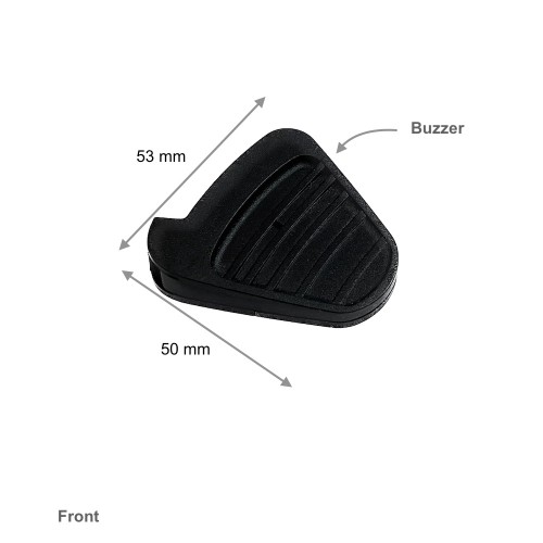

| Size | 53x50x12 mm (2.15” x 2” x 0.47”) |
| Weight | 20 g (0.7 oz) |
