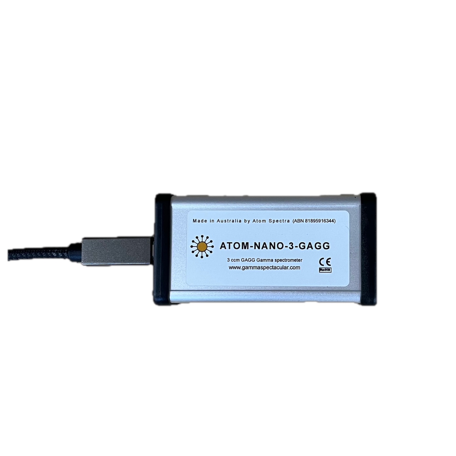

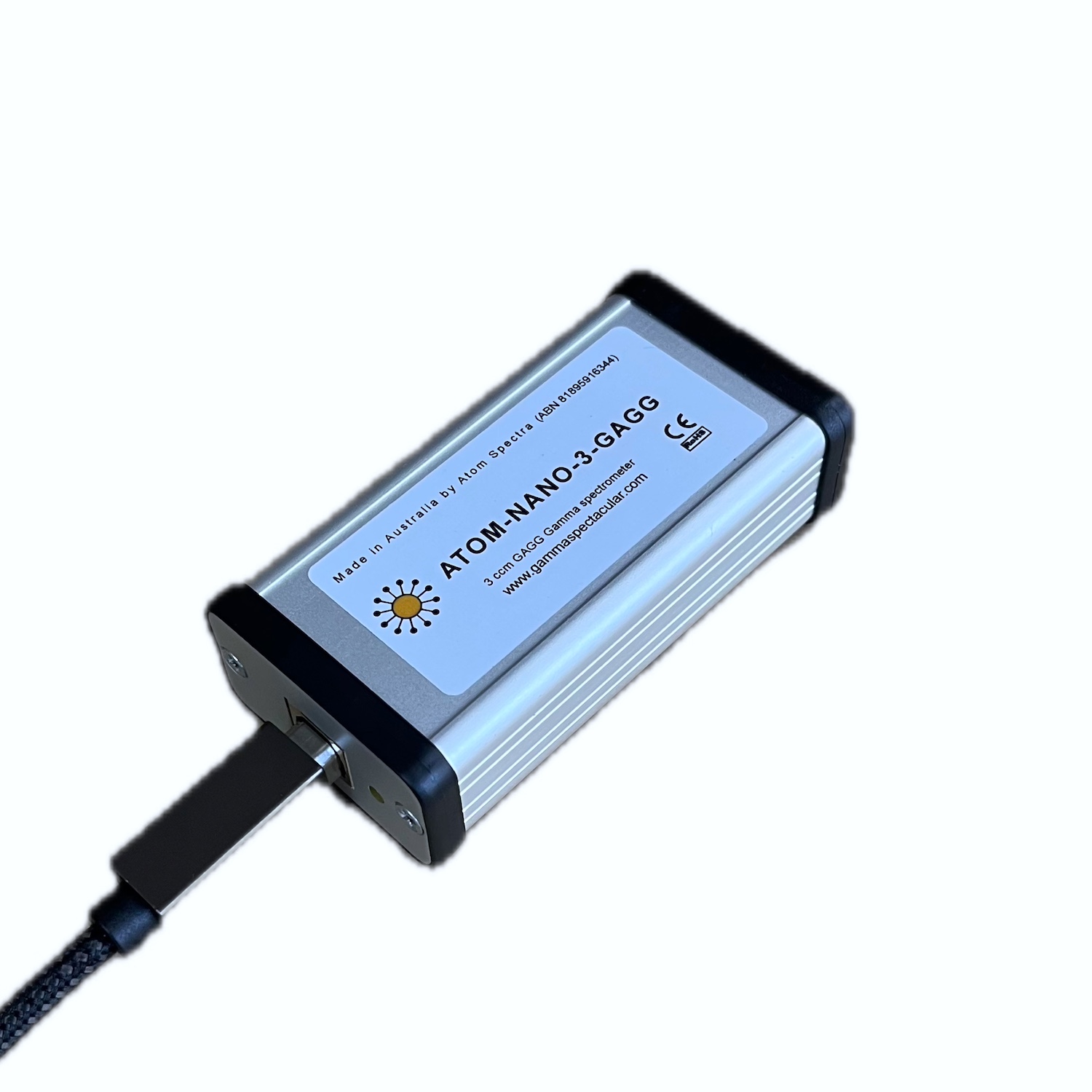

USB Gamma Spectrometer with GAGG Crystal
ATOM-NANO-GAGG offers high resolution spectrometry, in a small package with fully integrated MCA. The open source software provides a powerful interface with features like background subtraction and isotope libraries.

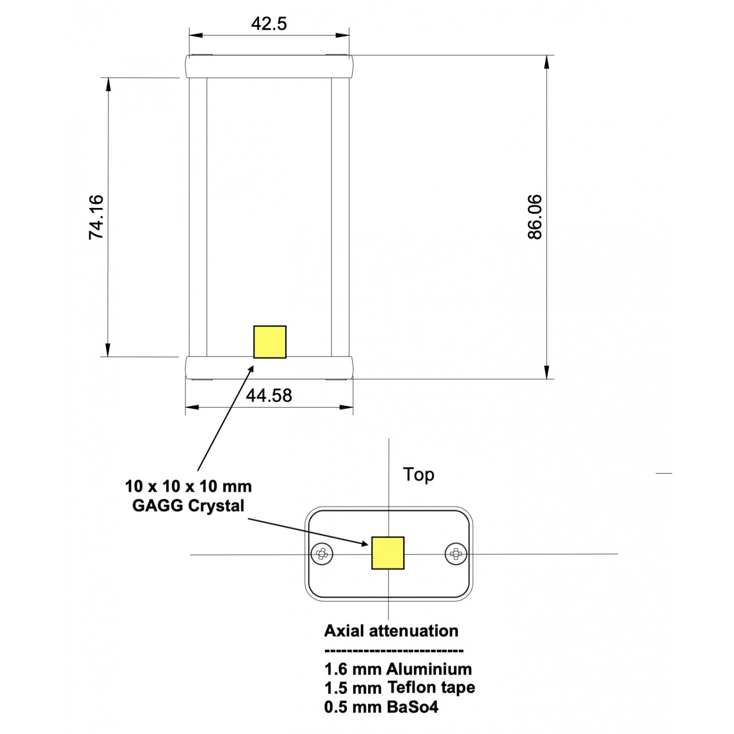

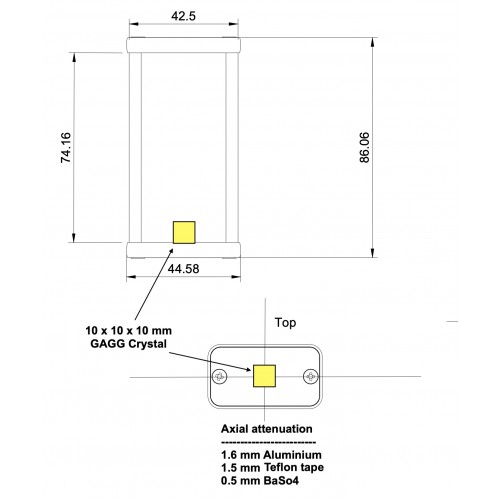

Scintillation Crystal GAGG
Typical resolution 5.6% (+ - 1%)
Power consumption < 1 Watt
Weight 130 Gram
Max cps. ~30,000
Dimensions 85 x 45 25 mm
Temperature operating range -20 to +60 C˚
Channels 8192
