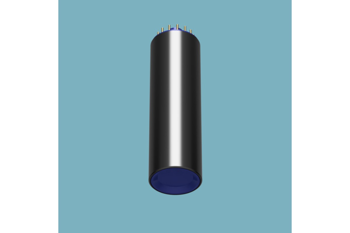

High resolution gamma scintillation detector with 25.4 x 25.4 mm (LaBr3) crystal for use with GS-MAX-14 Spectrometer.

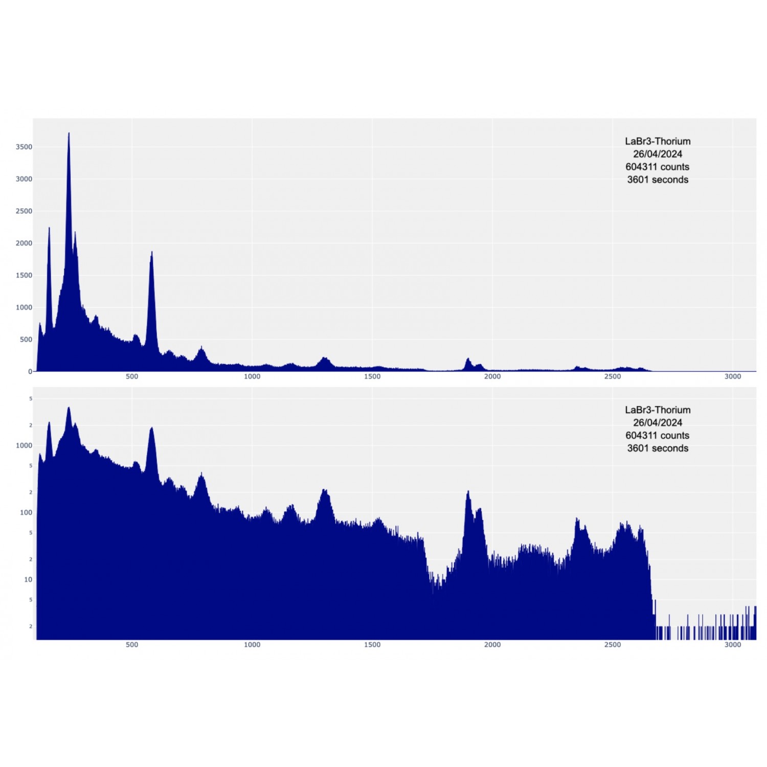

Expect to see a lot more detail in your spectrum with one of these tiny high resolution LaBr3 detectors, what they lack in size is more than made up for by the impressive resolution.
These crystals provide excellent resolution typically 3.5% or better at 662 keV.
The LaBr3 crystals are encapsulated and axially mounted to a 1.5" (38 mm) quality PMT with 12 M Ohm divider and a single SHV connector (BNC available on request), the whole assembly is padded and enclosed in an anodised aluminium housing with wall thickness ~0.6 mm.
