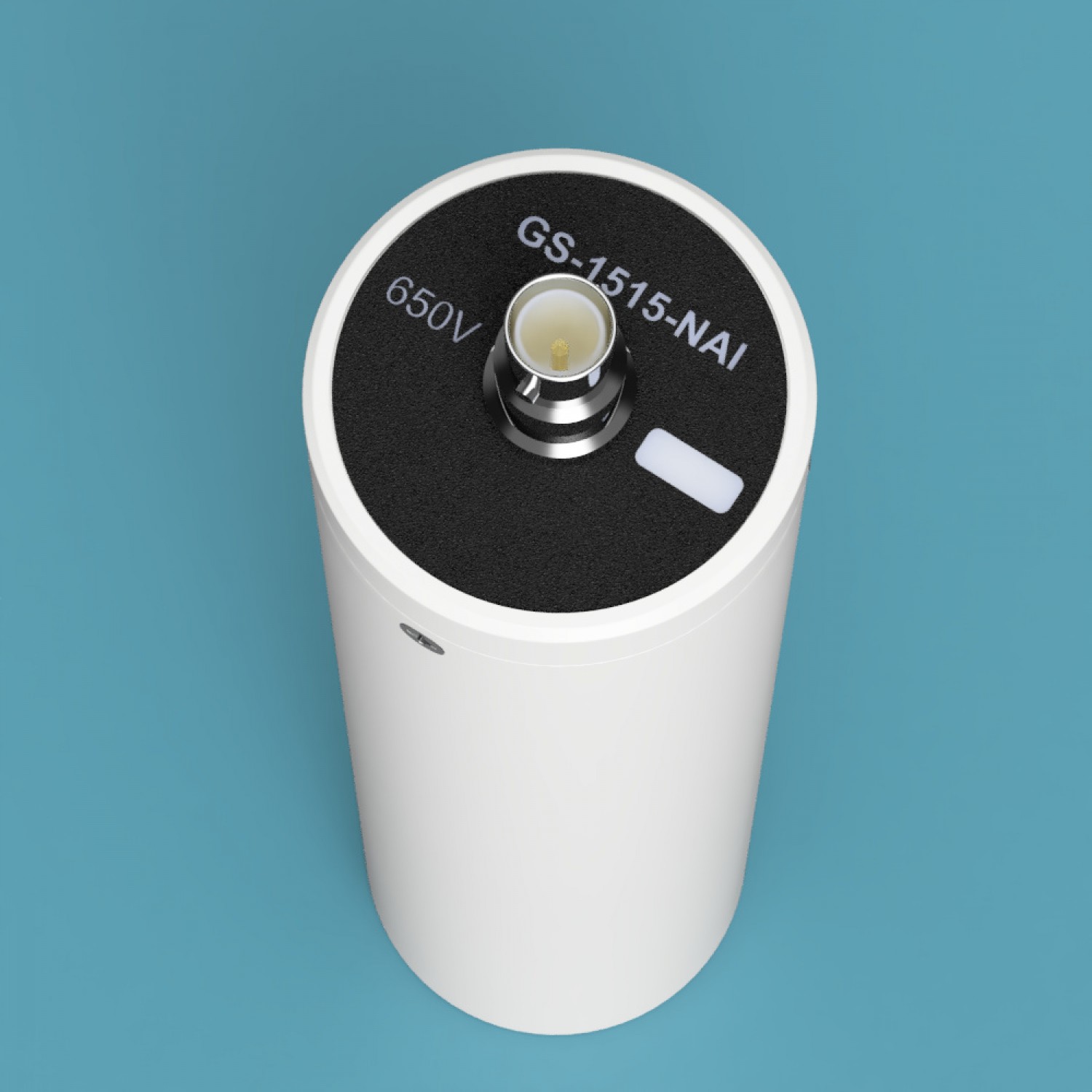

NaI(Tl) Scintillation Detector with 1.5 x 1.5" Crystal

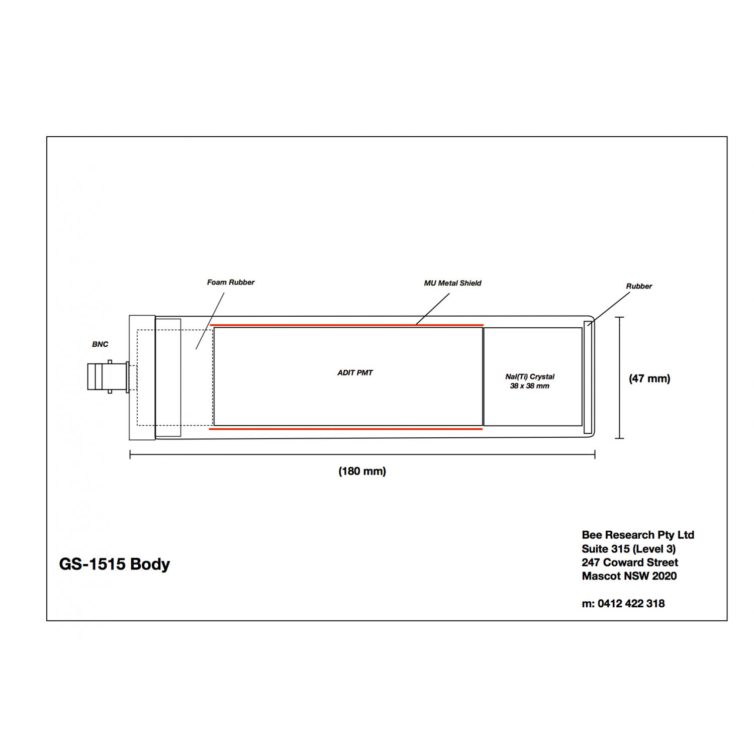

Great general purpose gamma detector with encapsulated 38 x 38 mm NaI(Tl) crystal, coupled to a PMT with integral voltage divider and fitted with an industry standard SHV connector.
The whole scintillation detector is housed in a spun aluminium housing and finished in pearl white powder coating. The detector comes standard with an SHV male connector, compatible with GS and many other spectrometers, but can also be supplied with the older style HV-BNC if required.

Scintillation Crystal NaI(Tl) (Bridgeman Growth)
PMT Hamamatsu R980
Connector SHV

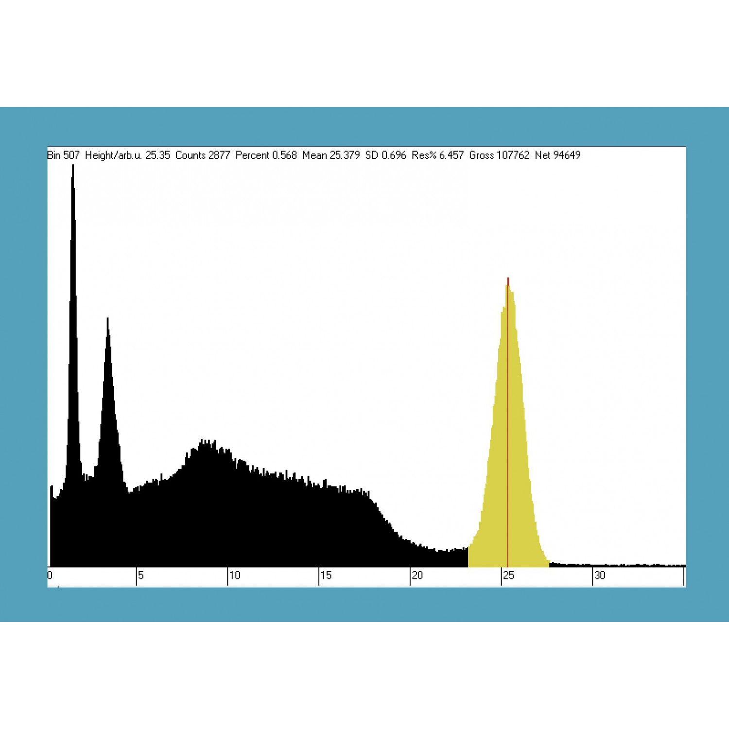

Background CPM ~950 (approx)
Resolution at 660 keV < 7.5 %
Bias voltage 650-850
Gamma efficiency @ 662 keV ~60%
