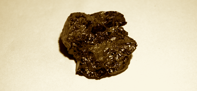

Polycrase Rock
I recently obtained this little piece of polycrase from an eBay seller. It weighs around 27 grams, and it is radioactive, showing around 47,000 counts per minute on a standard Geiger counter. Polycrase is a blend of uranium, yttrium, and oxide mineral with formula: (Y,Ca,Ce,U,Th)(Ti,Nb,Ta)2O6. It has a Mohs hardness of 5 to 6 and a specific gravity of 5. First described in 1870 at Rasvag, Hitterø Island, near Flekkefjord, Norway. It is now found in Sweden, Norway, and the United States.
Soon after receiving the mineral sample, I recorded a 200-minute gamma spectrum using the GS-1100A with my Bicron NaI detector, which yielded a good spectrum, here shown in linear scale.
